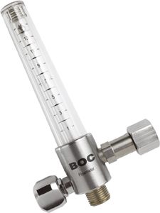

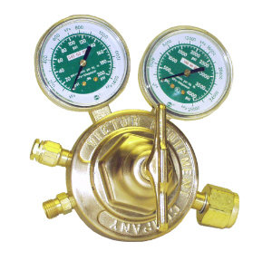

If the gauge reads Bar or PSI then its not the gauge you need. This is just telling you how full the bottle is. You need another reg' or a two stage regulator with a second clock that reads in Lpm (Ltres per minute) or SCFM (Standard Cubic Feet per Minute). Either that or one of those Flow meter type gauges with a little ball floating in a tube.
Flow meter
dual stage regulator
