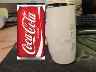

recently got an air compressor single phase motor maybe 3hp anyway took the cover off and seen the cap was blown.
what causes this?
if I get another one and wire it in would it likely run?
are then any checks to see if the motor is scrap? I have a VERY basic multimeter.
pic of the capacitor. says 420v 40uf there is also a 420v 20uf cap but it looks ok.
is it fair to assume 420v is the max volt for the cap and that it will work ok at 230v?
what is the 420v rating if not?
what causes this?
