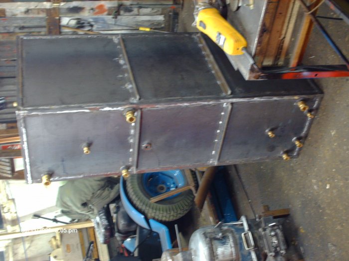

This is why I didn't have time to make my own welding trolley.
Its a 600 litre accumulator tank for a solid fuel boiler installation, complete with boiler charging coil, and solar charging coil, built from 3mm plate with 25 25 3 angle corners and braces. Welded entirely with 6013 rods, 10kg of the bleeders.
glad its done!!!
hydraulic test tomorrow, fill it first and check for leaks, then probably 5 - 10psi and see what happens, as it will be working at max of 15psi, I think a safe test would be 30psi.
here is the beast..
