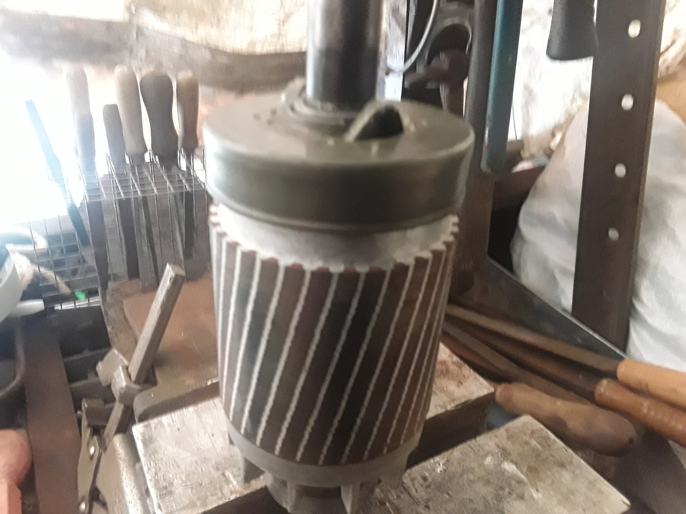

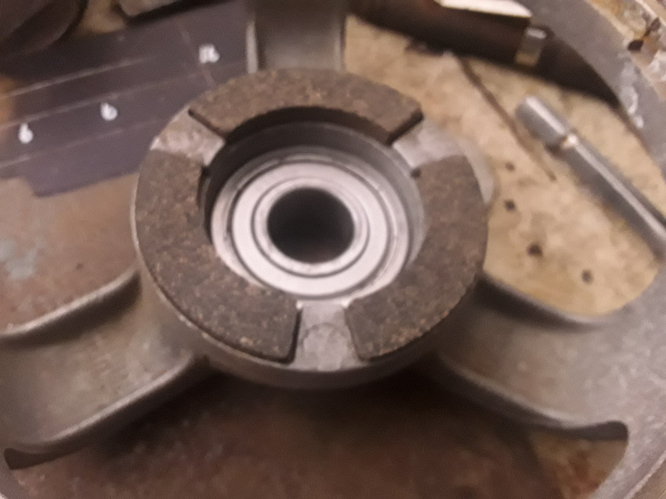

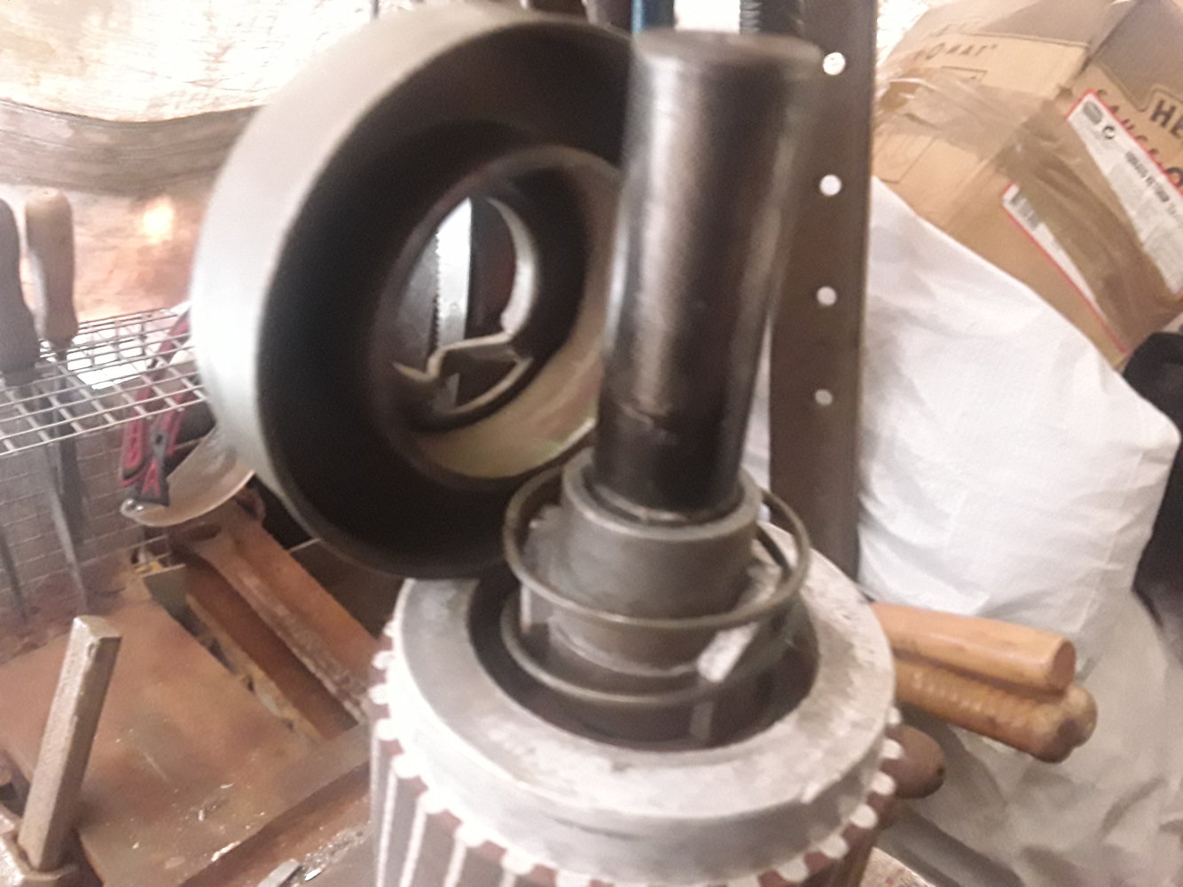

Electromagnetic brake. To stop the motor quickly when the power is removed. So you can still count to ten on your digits. The flow of pixies through the brake creates a magnetic force which compresses the assembly against the spring and releases the brake. Power off, the magnetism disappears and the spring presses it agianst the friction material.
