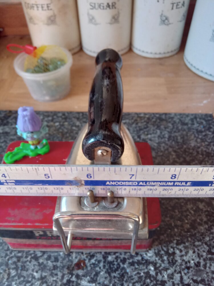

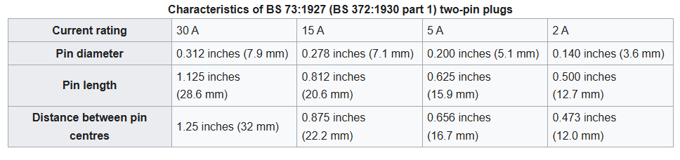

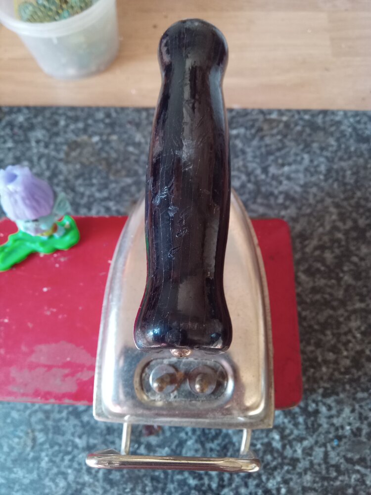

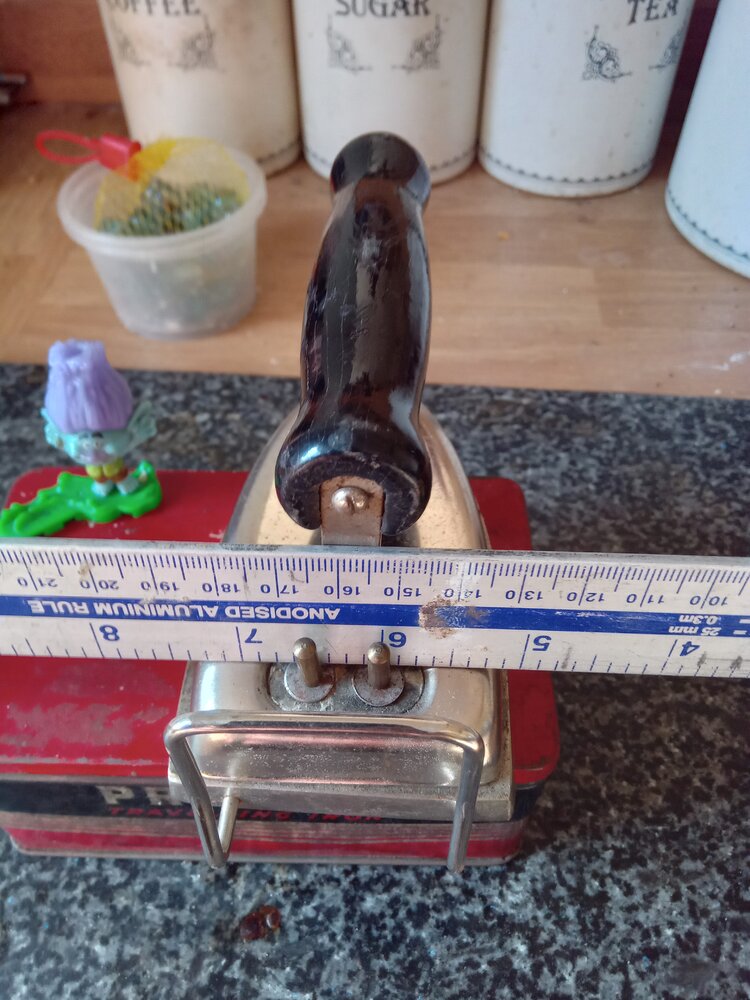

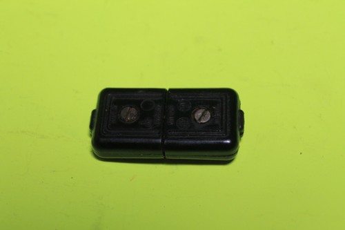

The standard Lawn mower connection or lightening flex connection do not fit. The pin spacing is too wide.
The original lead was fitted with a light socket connection and wired in rubber cloth coated cable.
