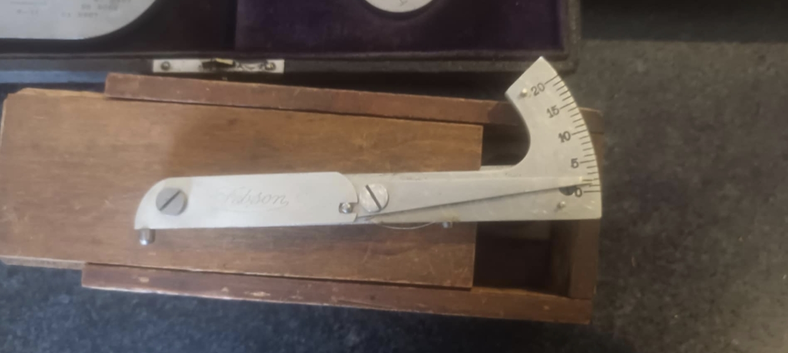

1930s indicator by Febson Mfg of London. It uses dual levers to magnify the movement of the stylus by 50:1 Although the individual levers move very freely, the leverage magnifies any friction such that it takes a fair amount of force at the stylus to make the pointer move. About 300 gm (10 oz)...
