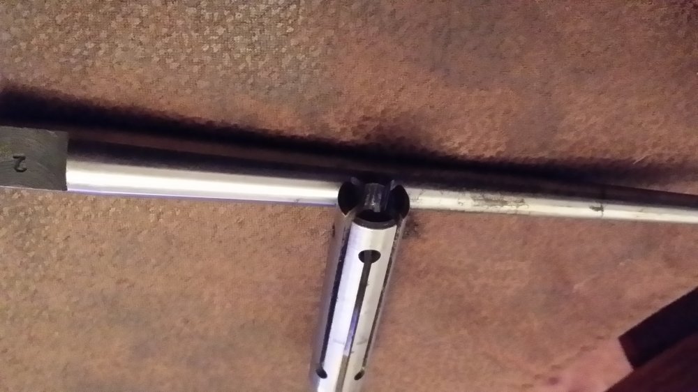

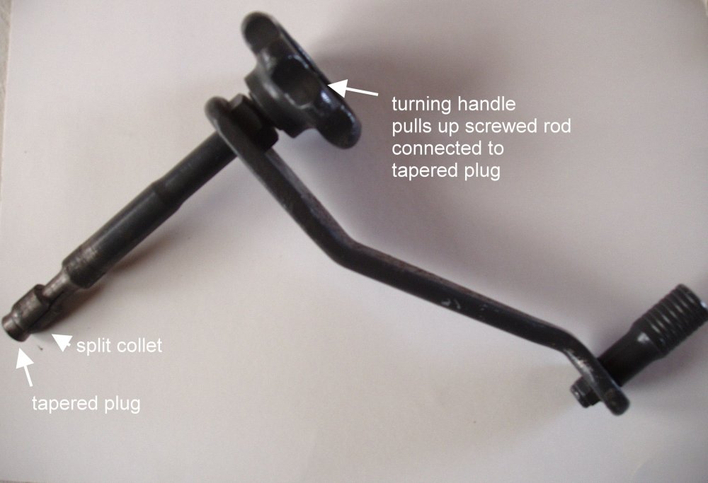

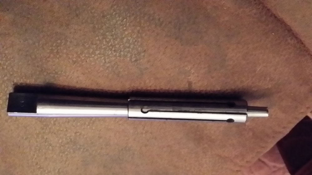

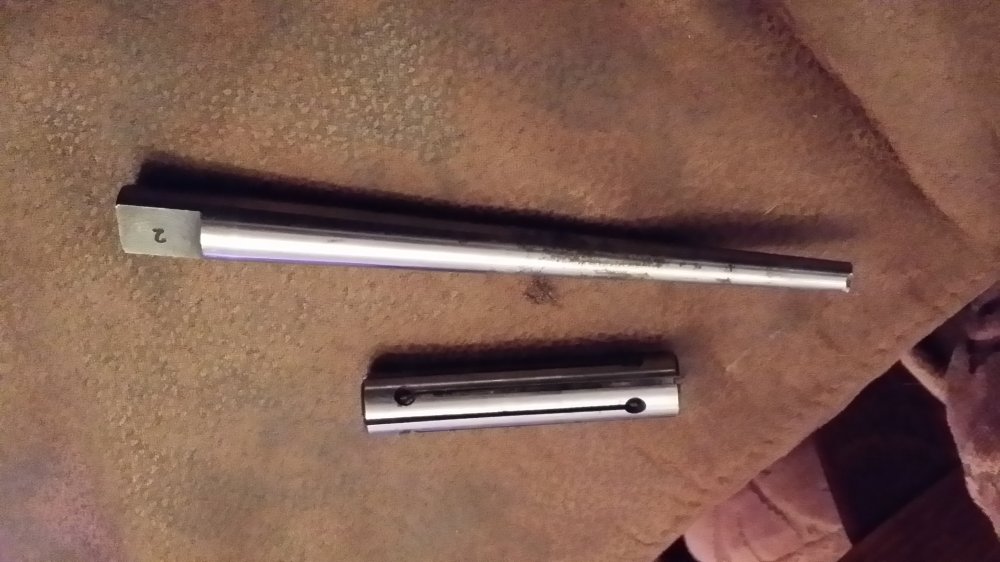

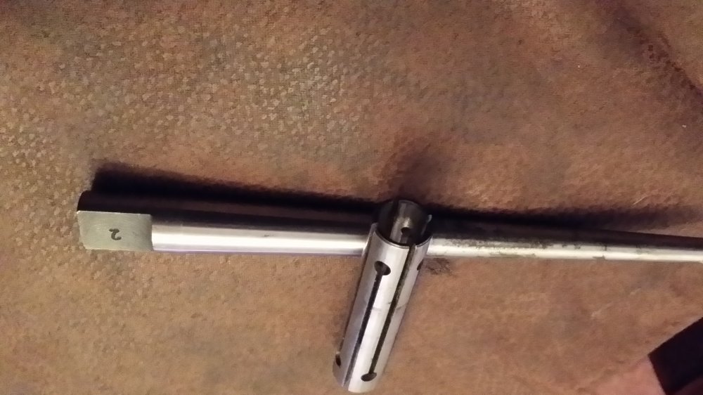

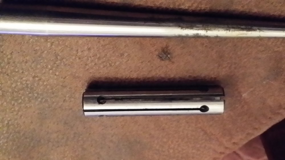

I found where I purchased it. lol http://www.ebay.co.uk/itm/RDGTOOLS-...Home_Garden_PowerTools_SM&hash=item51a3b0906bThat's very similar to a expanding arbor for lathe work, used for holding a cylinder you want to turn the whole od, but they have a parallel shank.

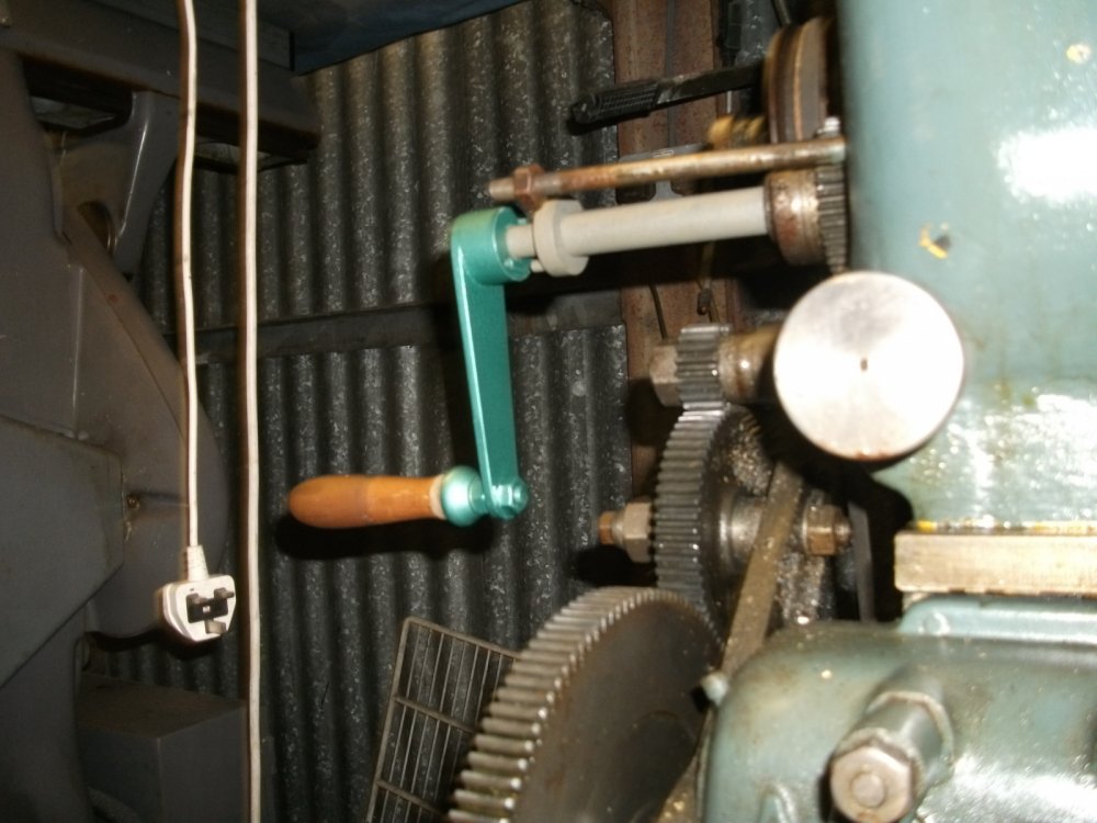

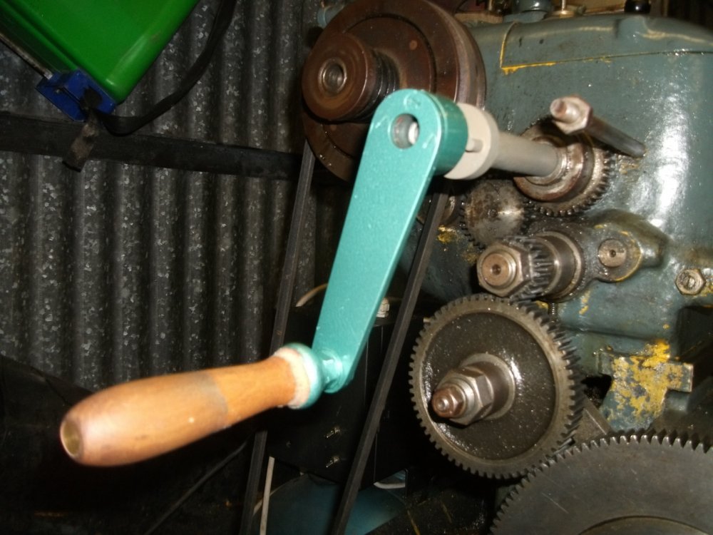

Made this handle, which works on the same principle for my Myford ML7 (fits in chuck bearing shaft). I use it to manually turn the chuck when I want to thread the work piece using a die box or tap in the tailstock. It allows you to put pressure on via the tailstock whilst turning the chuck to get the threading to start easier.View attachment 42185
