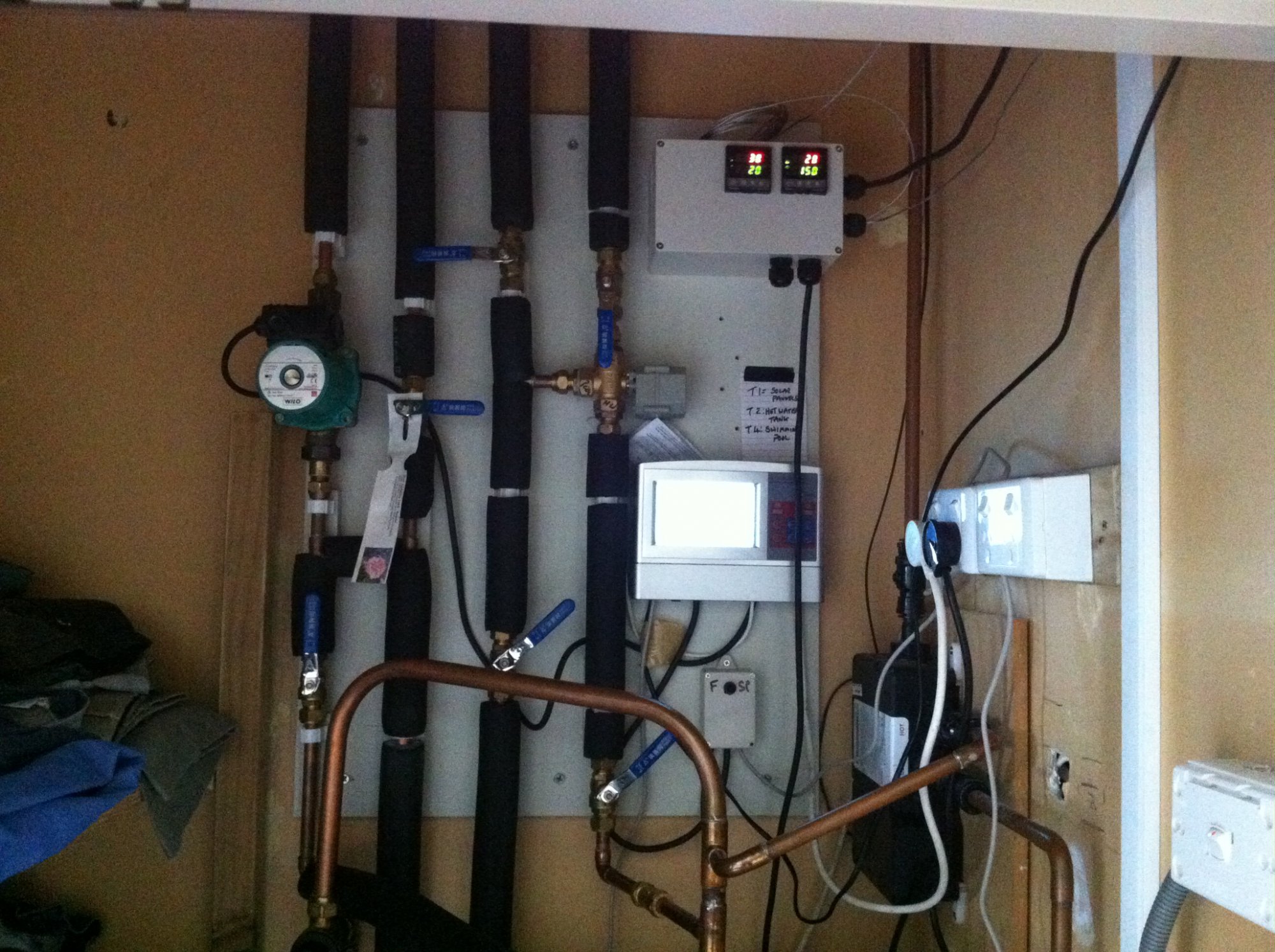

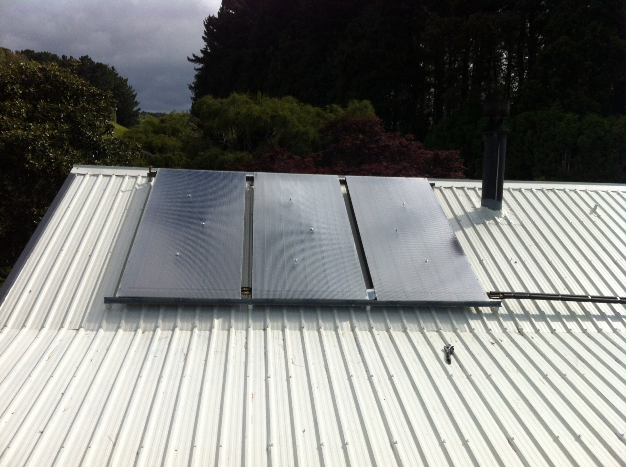

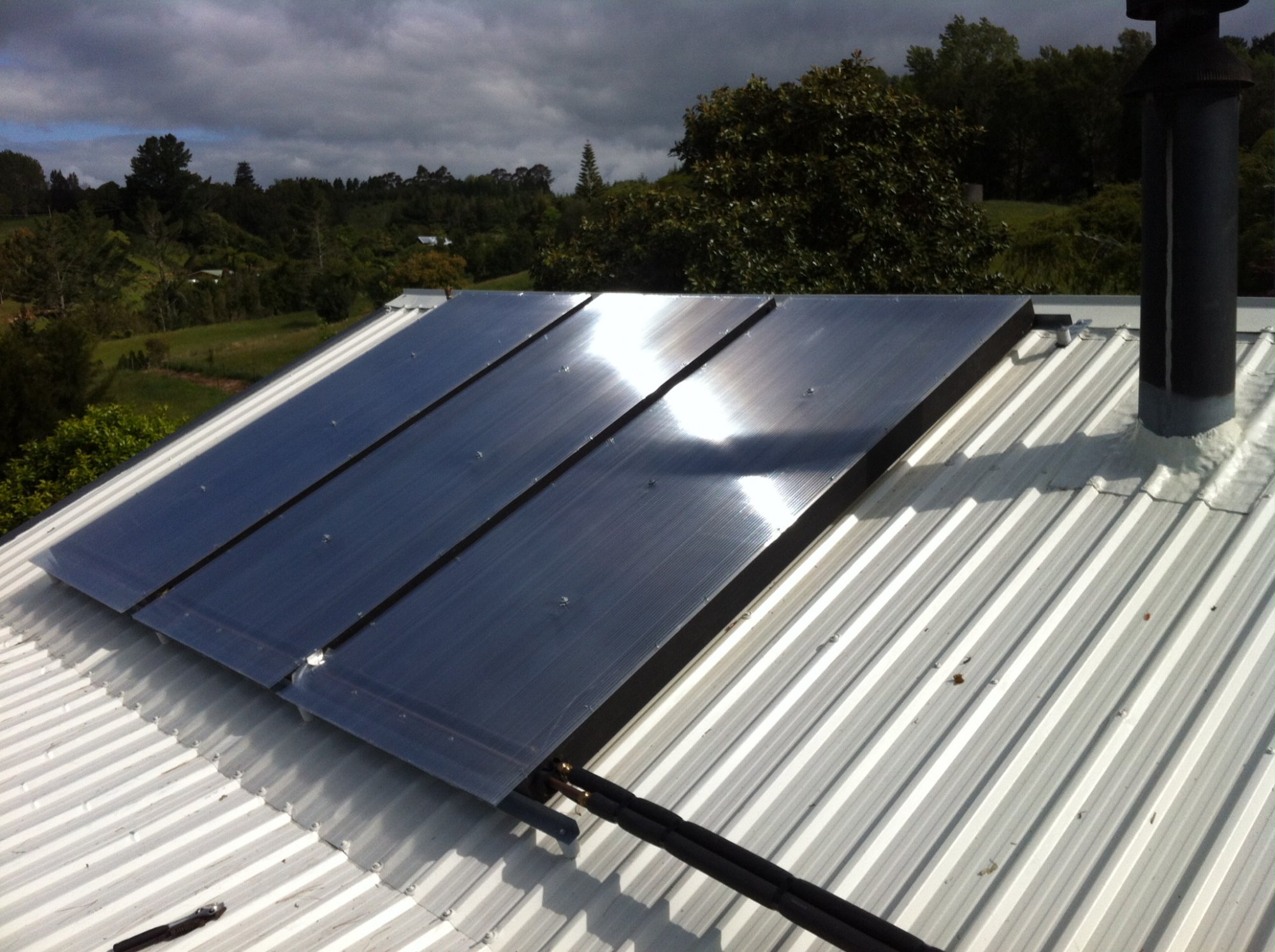

Finally got around to fitting my home made solar panels today.
Each one is 2.4 x 1.05m ( exact size of polycarbonate sheet ) each one collects around 2 kWh so 6 kWh in total.
I have built a 3 way system in winter it heats the hot water and then excess is used with an old aircon radiator and fan which heats the air in the house. In summer it heats the hot water and then the swimming pool.
Graham
