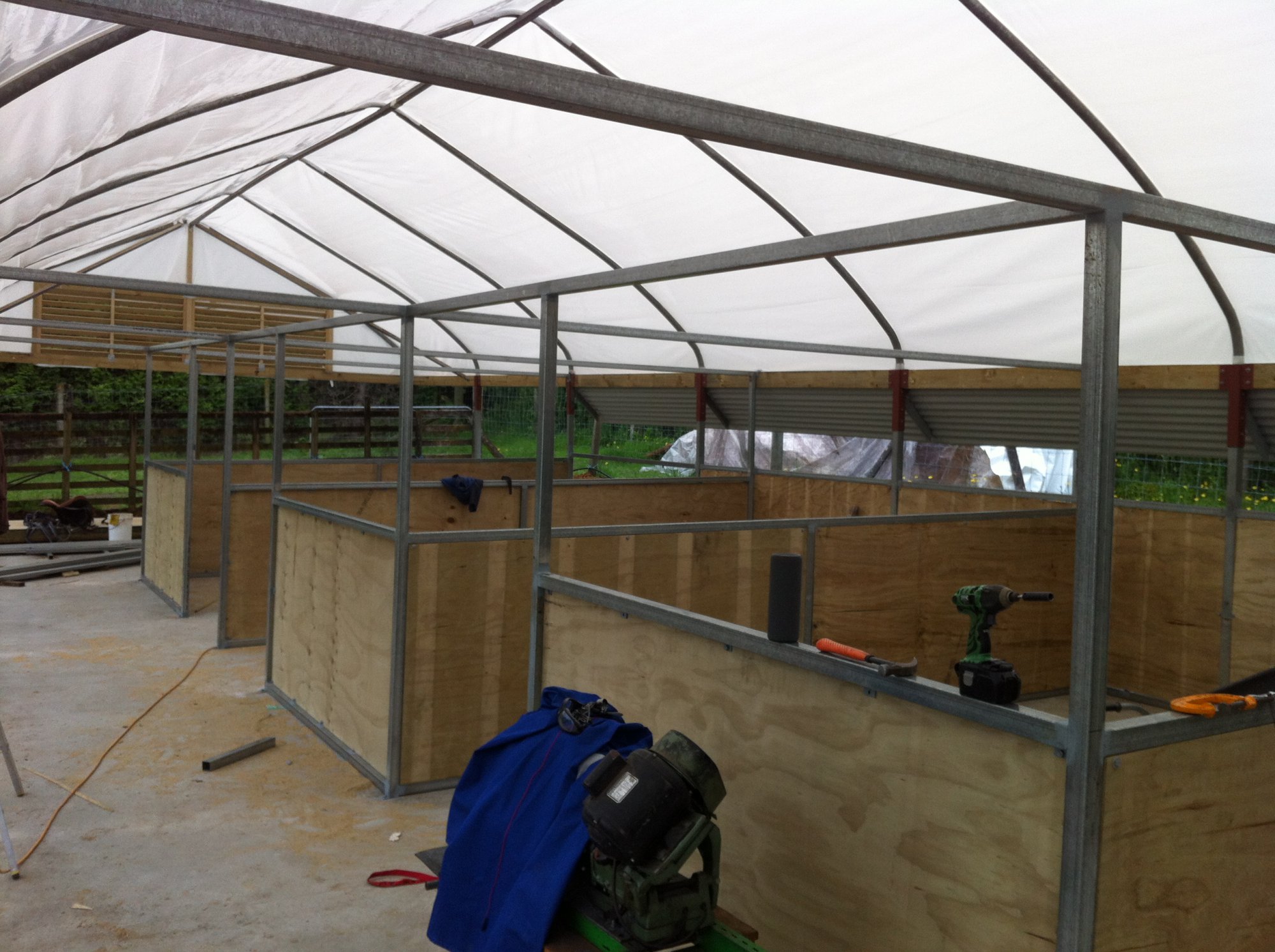

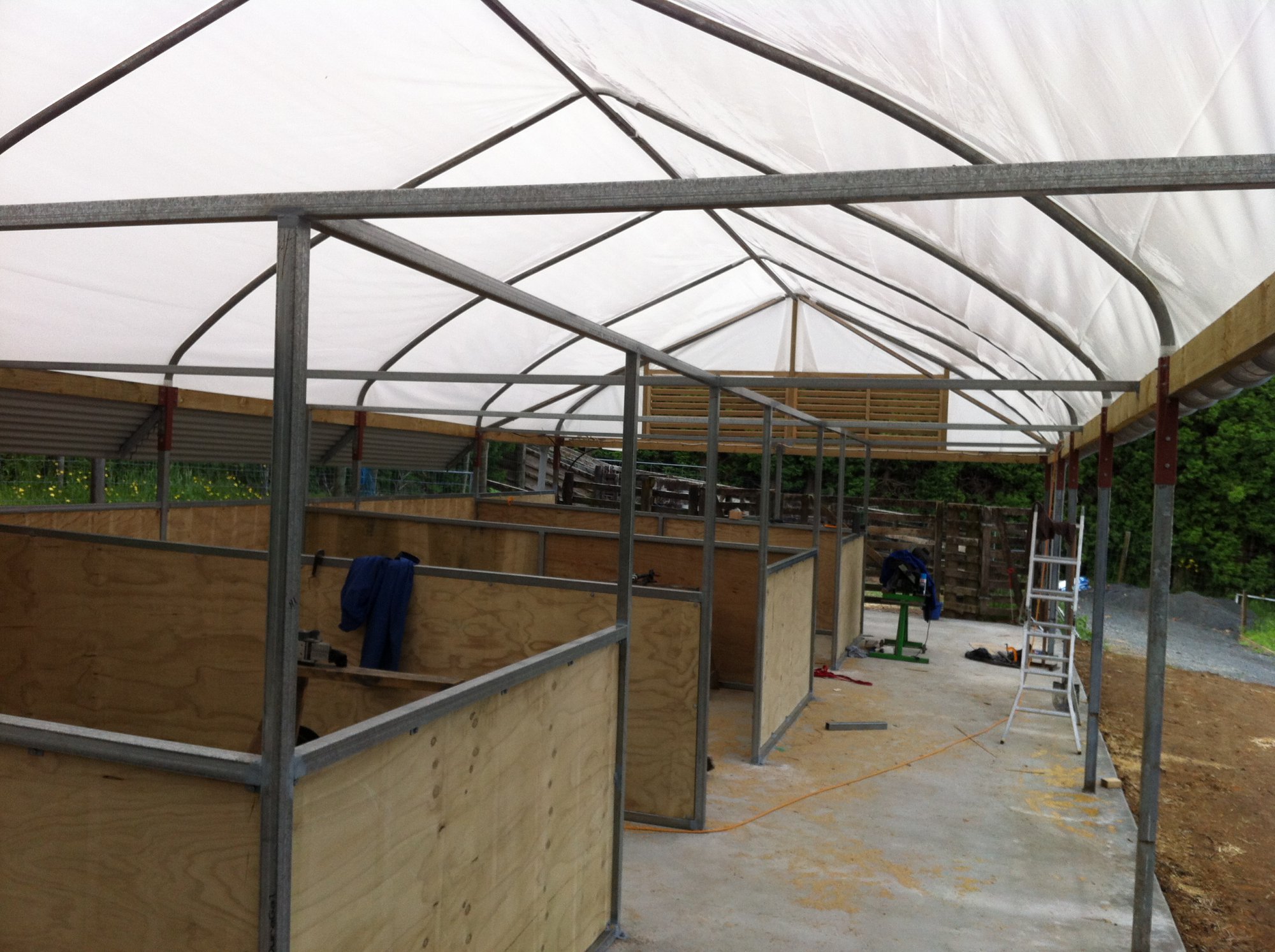

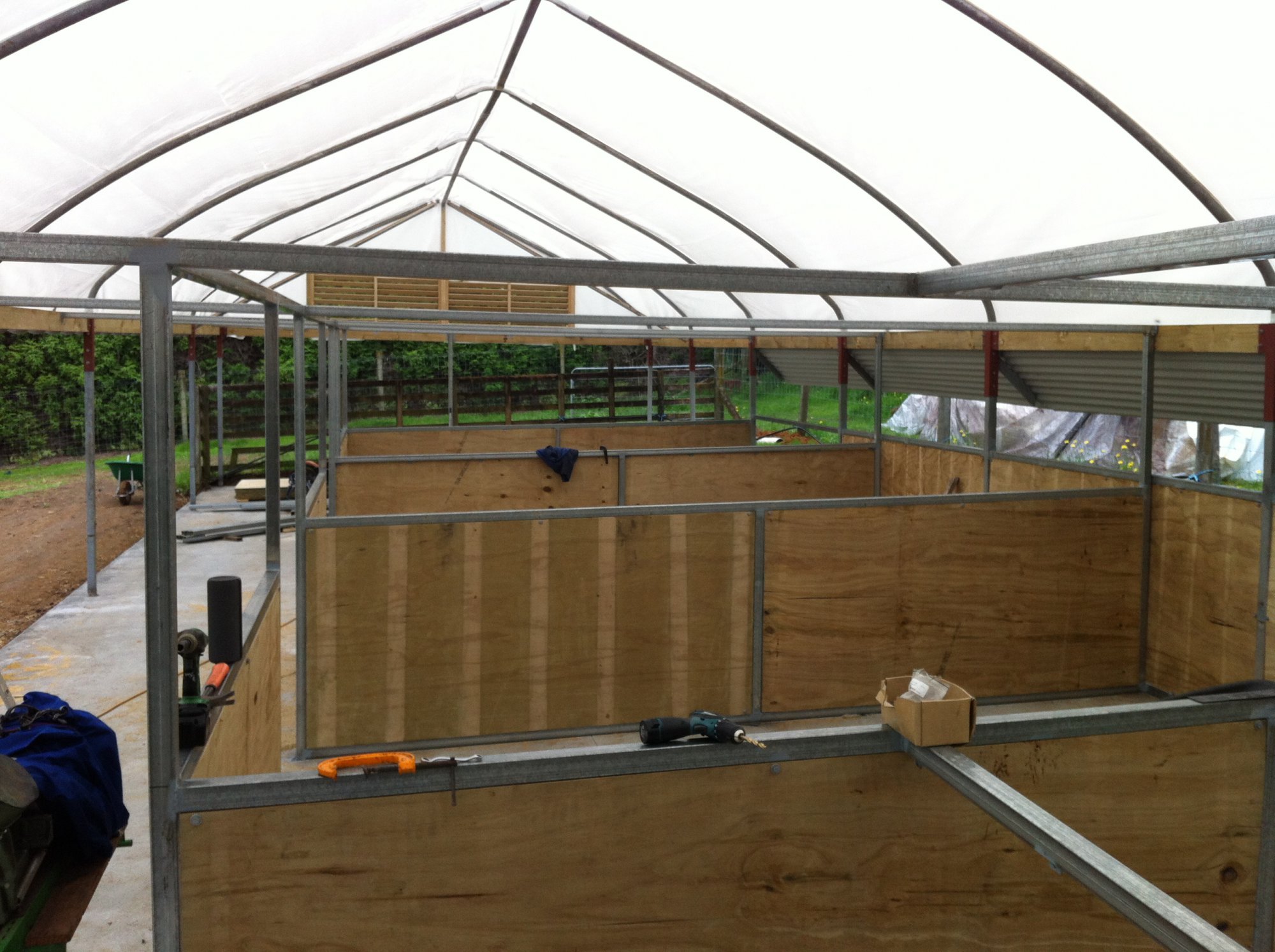

Not very exciting pictures but thought it might be of interest to some one.

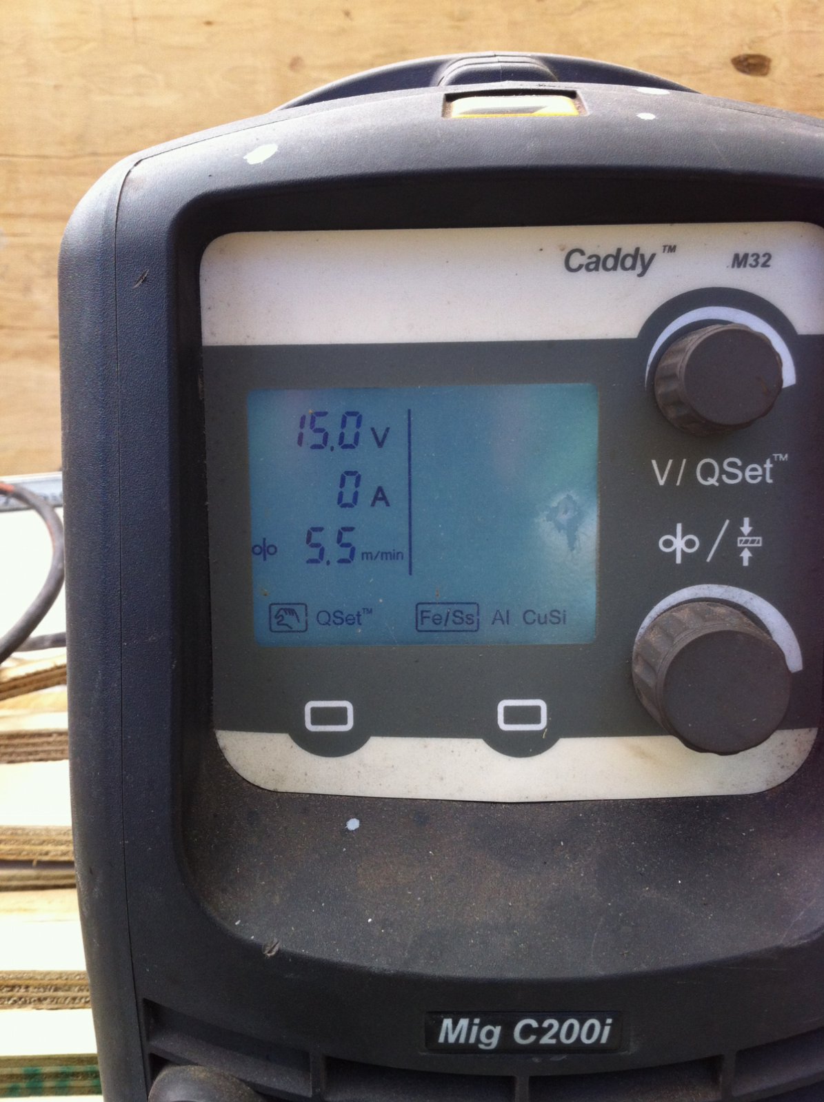

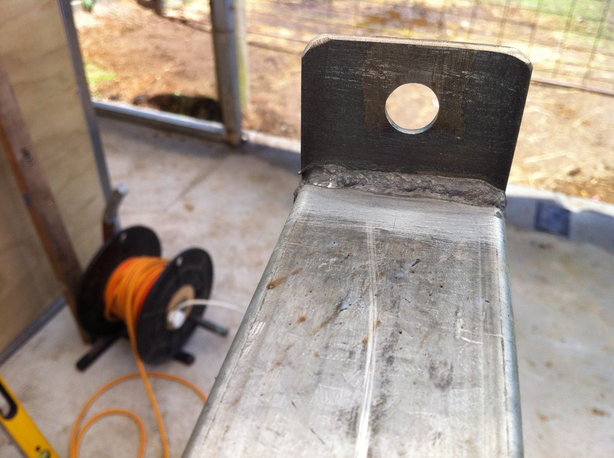

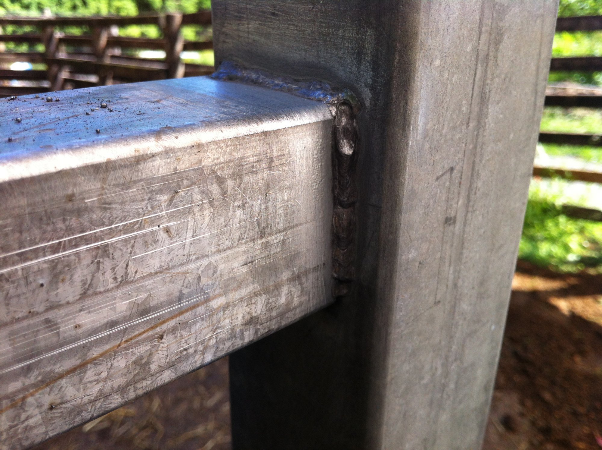

All done with gassless mig ( BOC Smoothcore GS over 5kg so far) 50 x 50 x 2mm super galv tube. I have to say I'm impressed with the wire once I got over the preconceptions I had. Welds very well and sticks like ........ to a blanket. The welds do end up looking like arc welds, and require cleaning afterwards.
Anyway not finished yet but they will be stables for the other half, her horses not her, who while willing to help is about as useful as a rubber spanner.
Graham
Forgot to say thank you to everyone who helped with my gasless issues !
