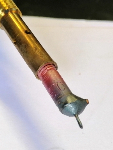

I've done this several times, it's the easiest solution to the problem.Just unscrew it, there's enough spring in the wire to let it rotate a few turns, pull it out a bit, then snip the wire off, fit new tip, and away you go.
I've also heard of that guy, who does it because it's daft to throw way a tip just because the end of it has some minor damage. There's a reason it has 10mm of spare copper after the thread.....I would like to comment on this one also. Not that I recommend to do this but I know 'some one' very well who has ground the end of the tip to remove the fused section, removed the tip, put a tip cleaned needle through the tip and refitted the tip. Since some of us are so poor and destitute, this is a win win situation. Can't let a perfectly good tip go to waste, can we?![]()
amd it worked perfectly after the minor modification. Or some he told me.Blimy I knew there were more reasons, it's good to see That I'm not the only one to 'know that guy'.it has some minor damage. There's a reason it has 10mm of spare copper after the thread.....amd it worked perfectly after the minor modification.
to a degree yes but, if too much heat gets into the swan neck then you can end up having to replace bits of the torch as well. For the price of a tip it could be false economyCan't let a perfectly good tip go to waste, can we?
