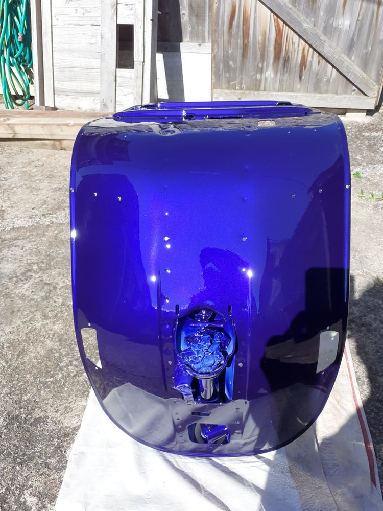

Hi. I have wet and dry paper up to 2500 grit. I’m currently blocking wet by hand at 400, 600 and finally 800 for the lightest of remaining unevenness and guide coat. I do have 1000 grit for a da as well. I’m a bit reluctant to use that on the uneven parts of a panel or the edges as I find it cuts through easily. Might be tempted to just very lightly skim it over everything beforehand.
