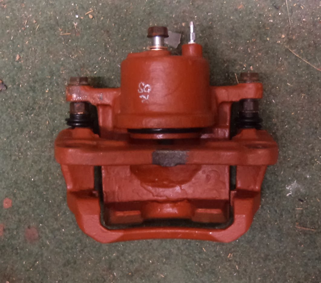

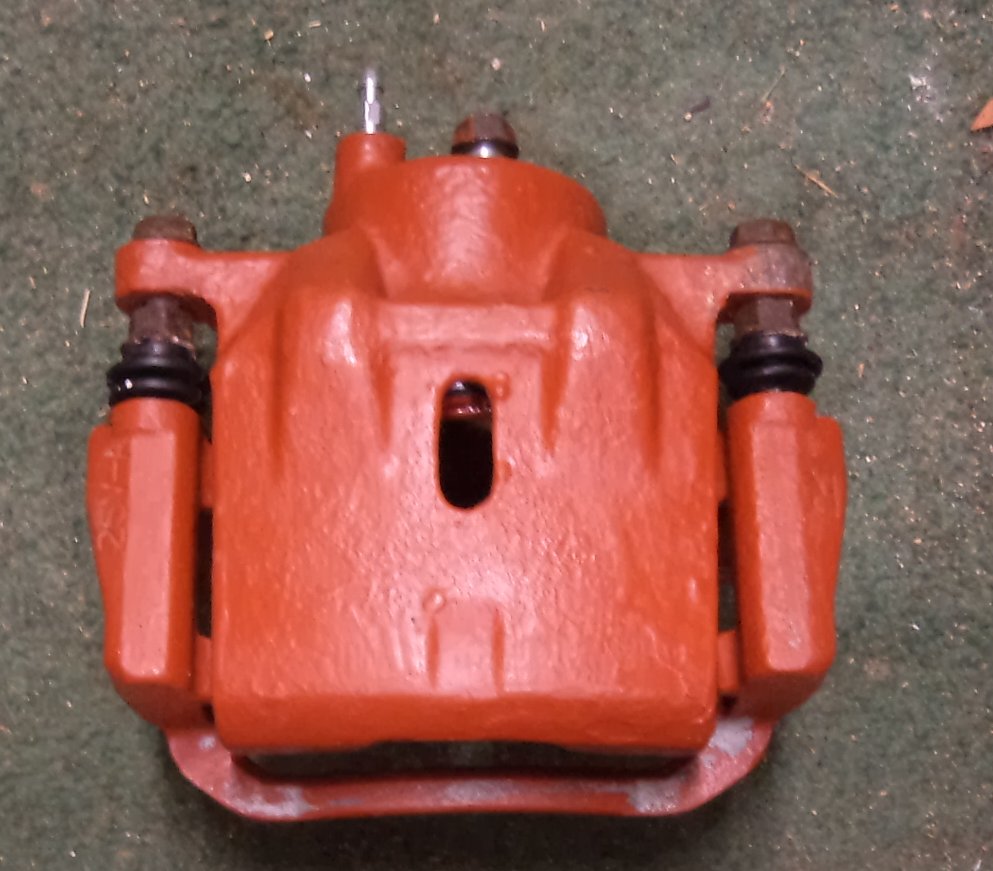

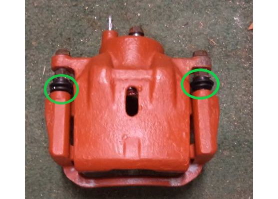

how old is the rubber parts?Well, trust me that there a fundamental issue in this particular case ; there's just too much rubber trying to occupy too little space. The component is just oversize and applying too much pressure on the slider. No grease will solve it. Unfortunately, I cannot see how to skim off 1mm off the diameter of the rubber gaiter skirt. Perhaps Mr Toyota's expensive spares dept can help.
