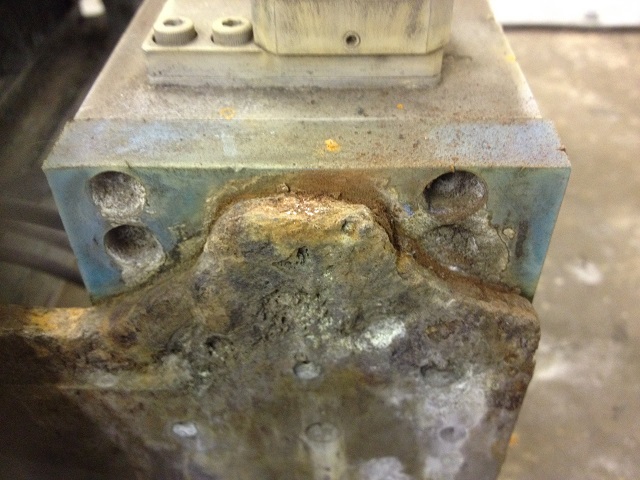

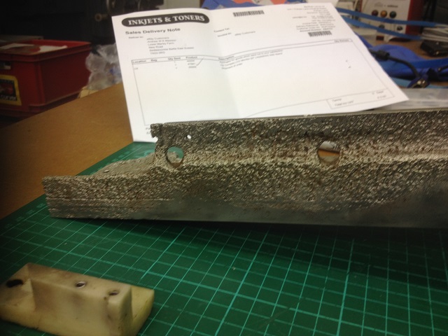

I'm making some new fittings for my Wire EDM machine. Electrolyte is de-ionised water which can be quite aggressive. What grade should I choose (or avoid) to minimise corrosion ?
Pictures are of parts of the machine when I was re-building it showing significant stainless corrosion - some parts were like swiss cheese!
I have no idea what grade those parts are. (Machine is 1984 Fanuc Tapecut Model M)
