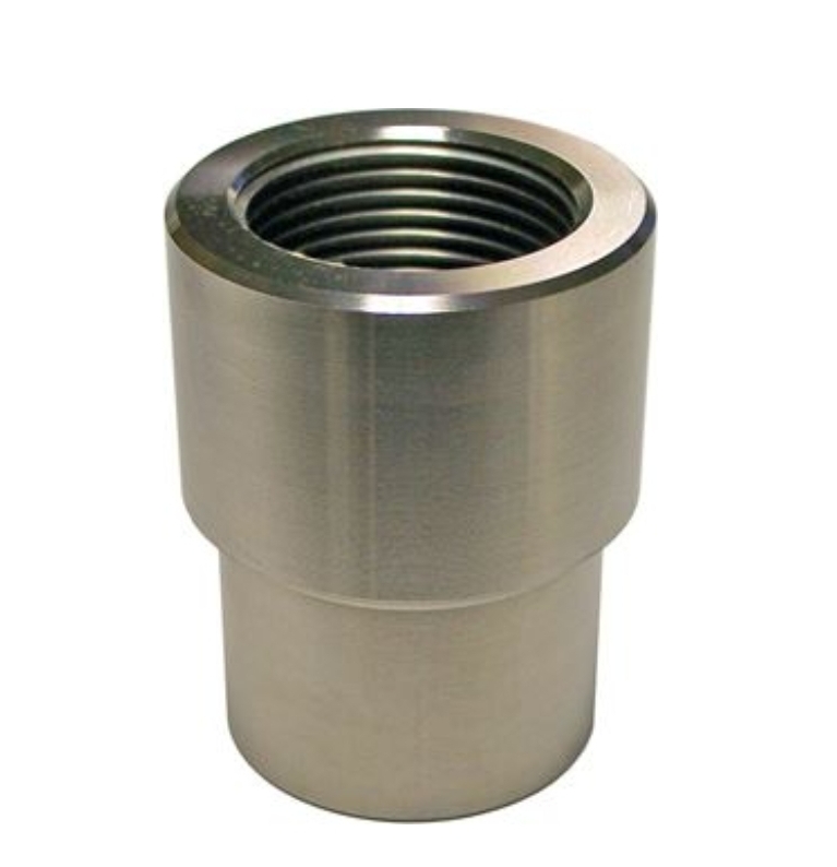

I need to make some weld in bungs
They will go into 2" OD, 1/4" wall seamless tube and the bungs will have a 1 1/4" × 12TPI internal thread to take a Johnny Joint
I can machine the bungs and cut the thread easy enough
The complete assembly will be part of a 4 link rear axle setup on my Jeep
I can get EN8 or EN3B, I'm leaning towards EN8
Will this be suitable?
