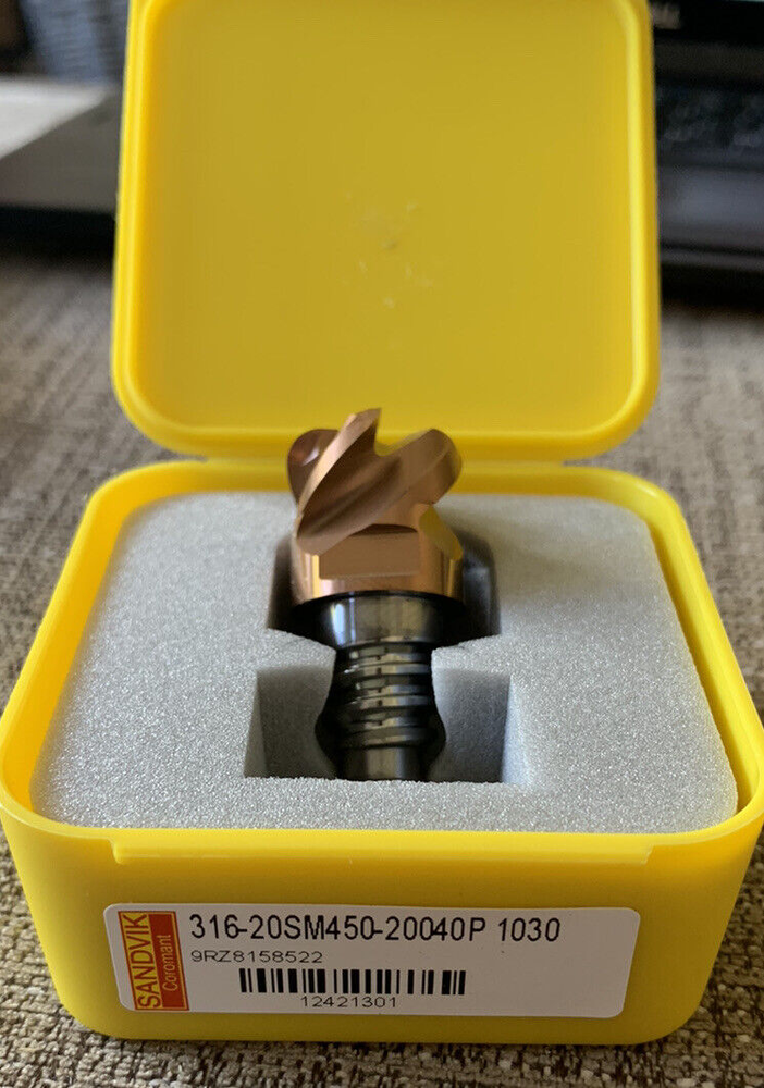

F fizzy Member Messages 13,284 Aug 11, 2022 #1 Very nice and shiny - I want one But what mill fitting is that?
northwest Searching for the Holy Grail......... Messages 6,371 Location Manchester UK Aug 11, 2022 #2 It fits into a holder, I have a couple, I will take a pic.
Kram Member Messages 7,891 Location Sussex Aug 11, 2022 #3 Looks like a Coromant EH fitting, Coromill Sandvik Coromant www.sandvik.coromant.com
S Shiny Steve Member Messages 312 Location kent Aug 11, 2022 #4 We use them at work fizzy, there bloody brilliant as long as they don't get totally smashed, as you tend not to be able to get them out of the holder.

F fizzy Member Messages 13,284 Aug 11, 2022 #5 Shiny Steve said: We use them at work fizzy, there bloody brilliant as long as they don't get totally smashed, as you tend not to be able to get them out of the holder. Click to expand... What are they typically used for? They look pretty cheap for what they are. Around £20.

G Guzrik Member Messages 717 Location Holland Noord Brabant Aug 11, 2022 #6 They look identical to the Iscar system we have at work. Idea is you don't replace the whole shank everytime mill has a mishap

S Shiny Steve Member Messages 312 Location kent Aug 13, 2022 #7 They are used for high volume production processes so you don't need to re set tool hight when the cutting head is worn. We use them are used as a general milling cutter.
