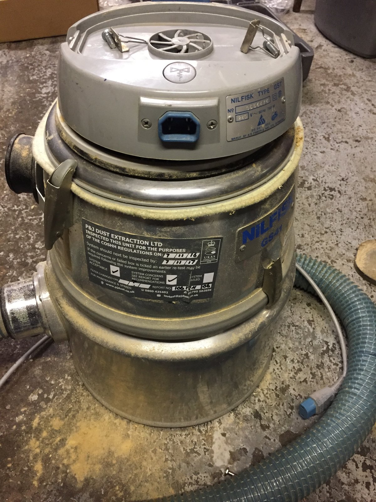

Just thinking - does that mean there's a possibility there may asbestos traces in it, if it's second-hand? How would you "make-safe" something like this?This is a very common type of vac used by asbestos surveyors to clean up small amounts of debris when taking samples.
should be fitted with a HEPA filter and appropriate bag.

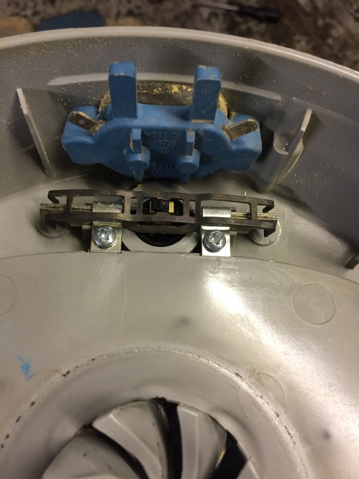

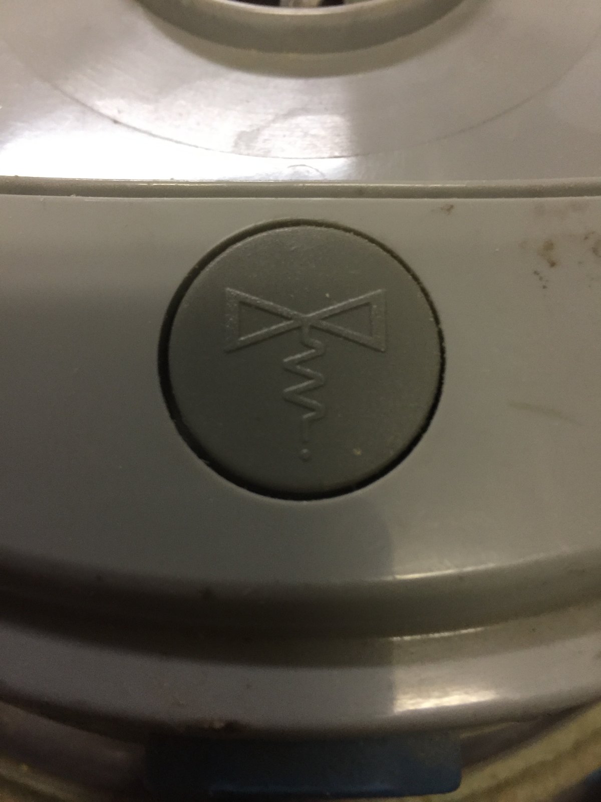

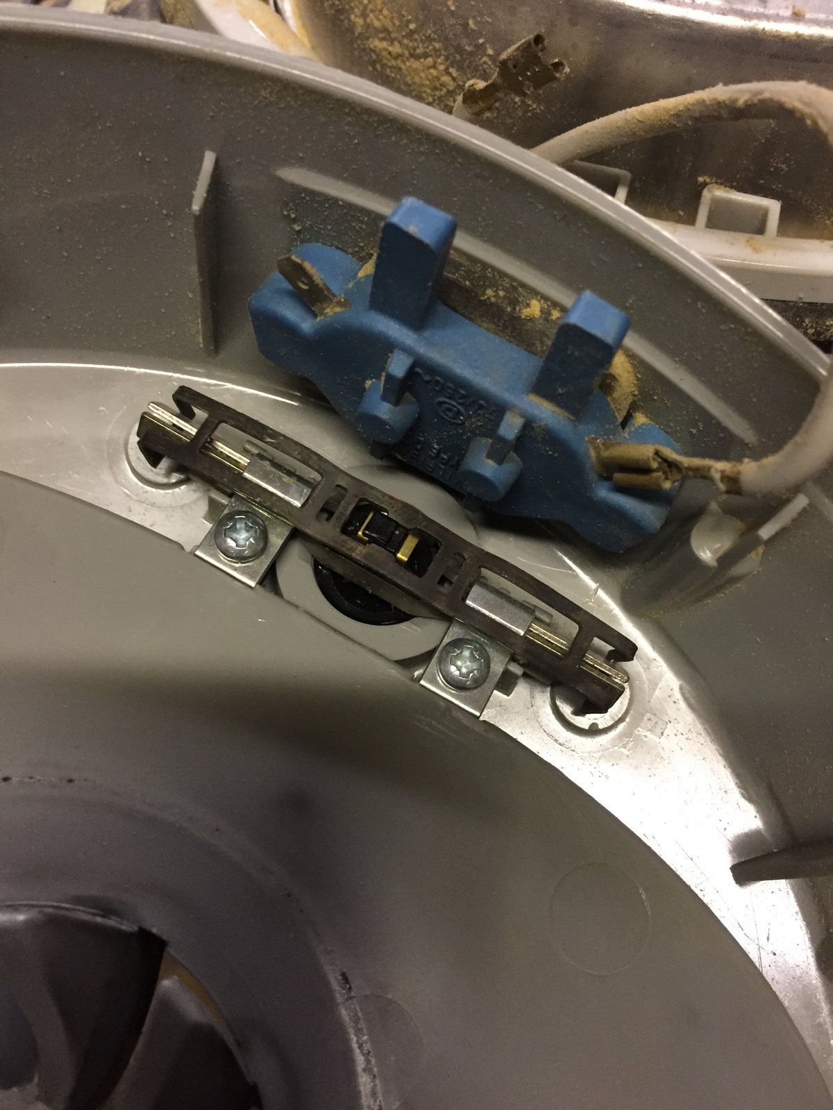

that switch is a shake down for the filter. They are almost always disabled
Interestingly, where has it come from? Do you know?Cleaned the existing filters and took it all apart and gave it a good blow out (don’t worry, I know it wasn’t used for asbestos in its past life):

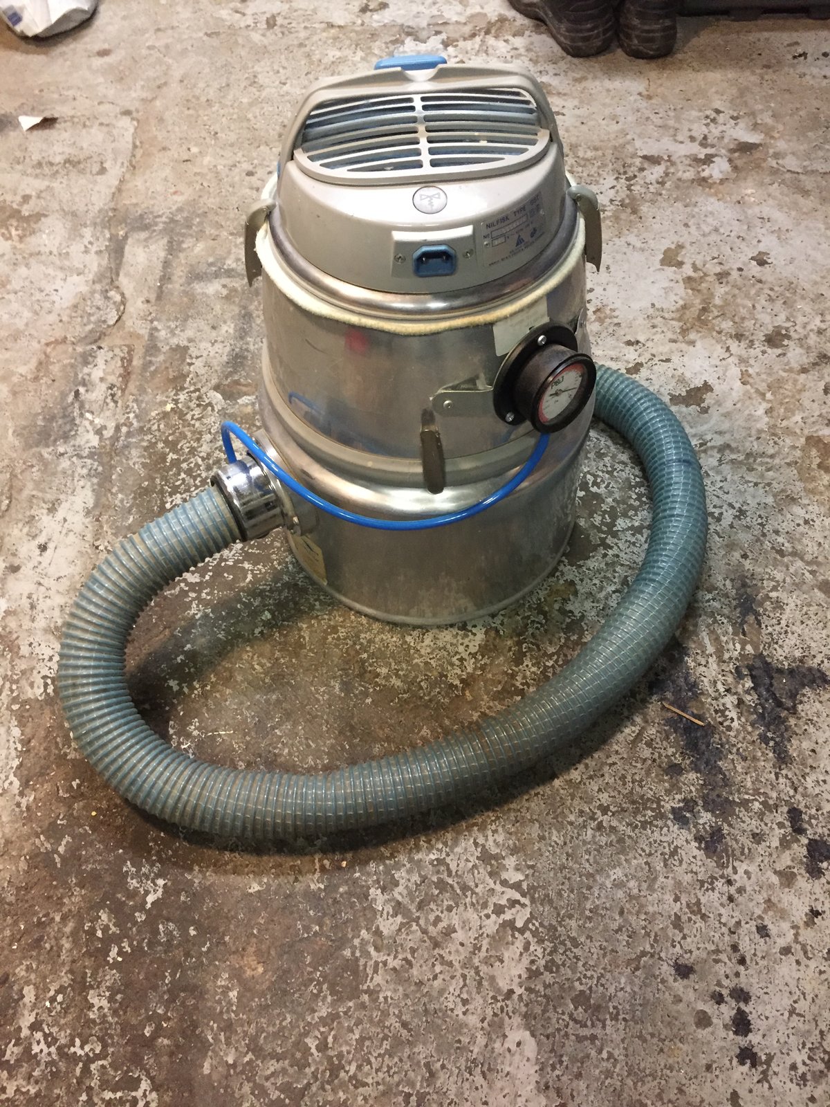

It’s very unusual to have a magnehilic gauge fitted on a vac. It will have been done for a very specific purpose or application.
Great machines and bomb proof
It came out of a school workshop that was closing down because the government thinks we don’t need skilled trades any more. Came with a folder of LEV and filter change records since the year dot (or at least until a few years ago when they couldn’t even afford maintenance).

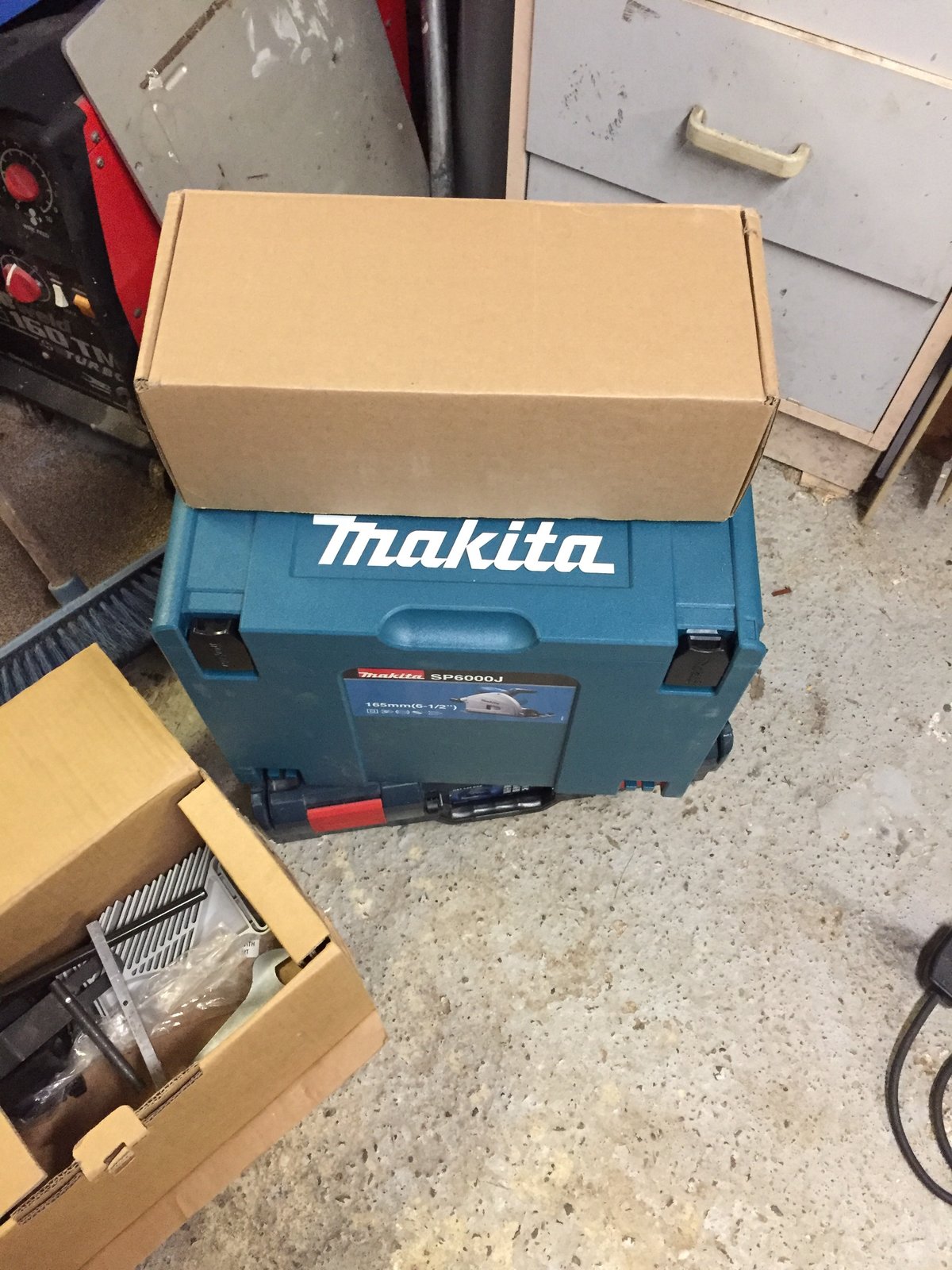

Bodged up a hose and gave the plunge saw a whirl this morning - both work great! Will add to that thread later.
