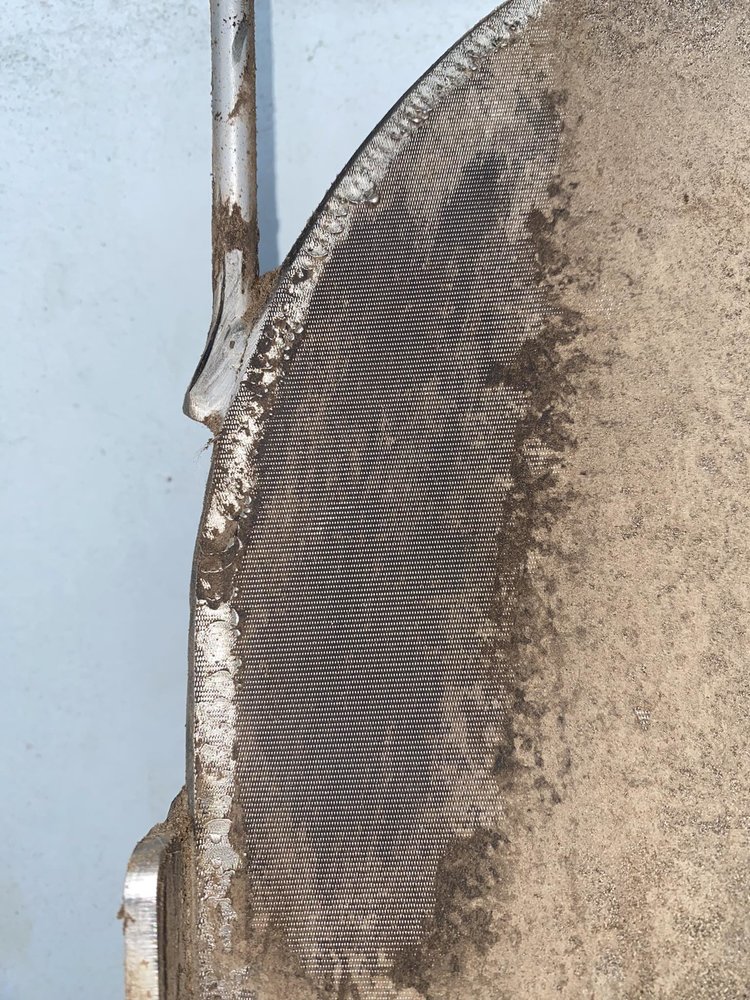

can you solder mesh to stainless steel bar sir?Difficult to judge scale from your image, but the example you've given looks to be soft-soldered.
Don't think you could get to a low enough setting on mig not to just blow it apart.
is it tough? if properly done.Yes.
Tough enough for a mesh like that in typical filter applications. What's your usage? Another way of securing mesh is to have the edge crimped into a u-shaped frame.is it tough? if properly done.
also thinking about that crimping idea. usage is for vibrating filter.Tough enough for a mesh like that in typical filter applications. What's your usage? Another way of securing mesh is to have the edge crimped into a u-shaped frame.
