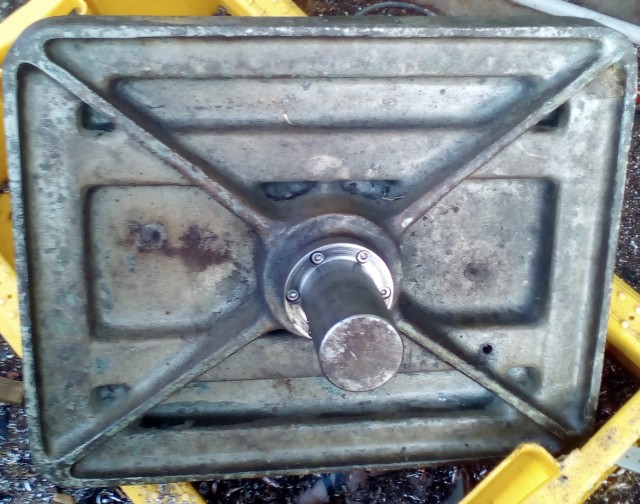

Fixed table

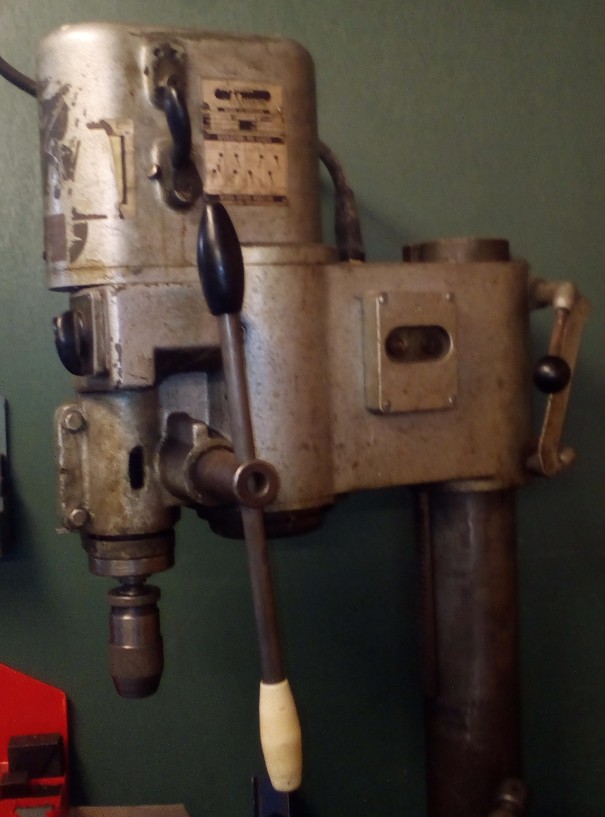

Head side view

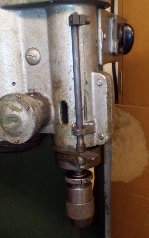

Release lever for morse taper in normal position.

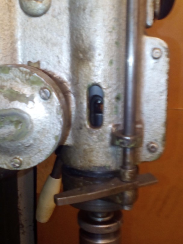

Slid out and if you look closely you can see the pin that knocks the taper out when you raise the quill.

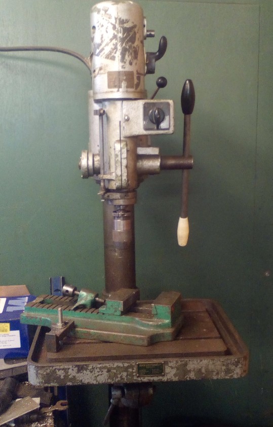

Finally full view.
