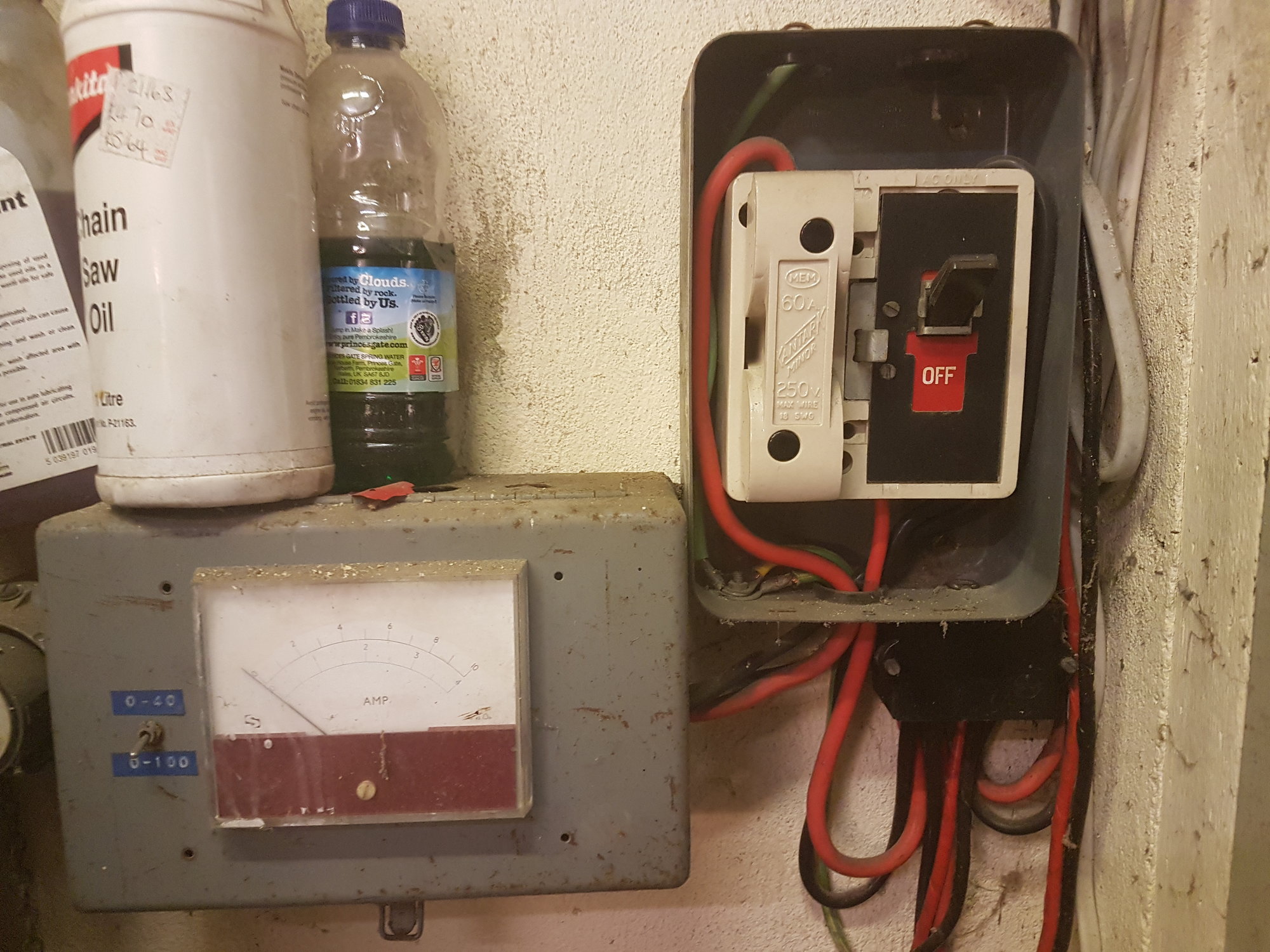

Whilst wiring up my 32 amp and 16 amp sockets i remembered this
now is it just a amp meter to see what current is going through the socket

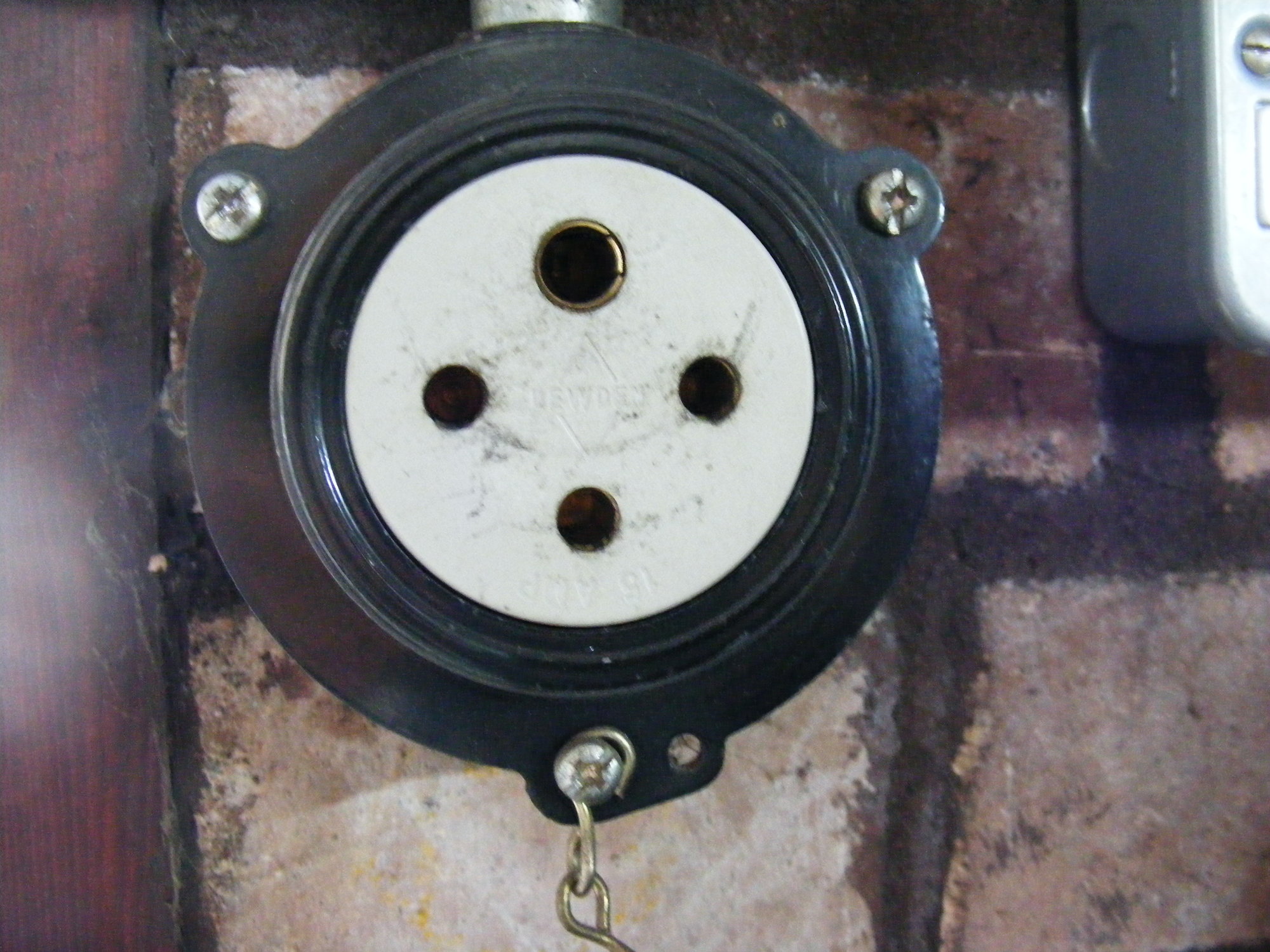

Never heard of them lol bit.like a 16amp but metal with screw on capyes I presume that's an old reyroll socket to the left of ammeter
yep it isNever heard of them lol bit.like a 16amp but metal with screw on cap

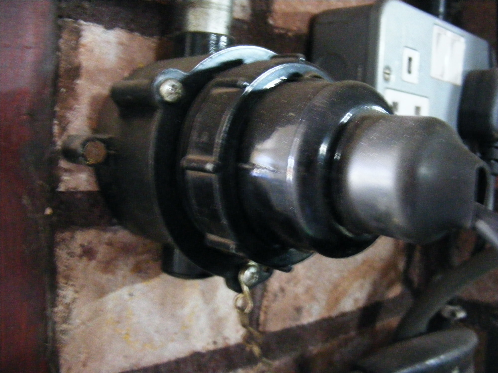

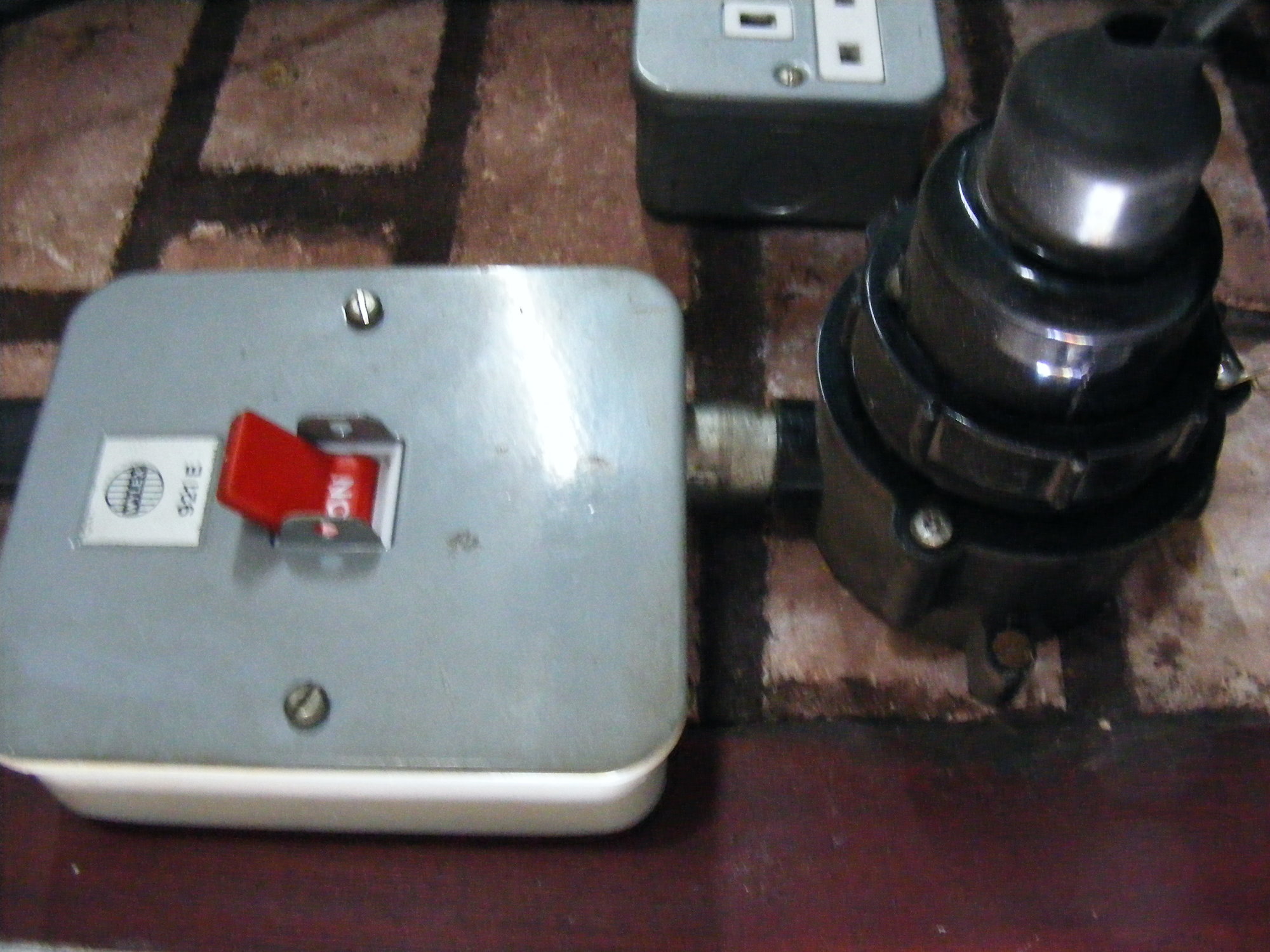

I HAVE a few of those type plugs dotted about the garageThey were usually 50v/55v if I remember correctly.They had a fused plug with the longer top pin being a screw in fuse.
Cool so I can just change that socket to a 32 amp too
you would need to change the supply fuse, otherwise you could get 60A out of a 32A socket, or the socket and cable would melt before the 60A fuse blew.
the box may contain two current transformers, on 0-40 it reads the bottom (0-4) scale, 0-100 reads the top scale(0-10).
yes thats them! similar to my garage, although I do not have any plugs for them so safer for me to swap them overView attachment 145100 Never new they were called that marked 15A
View attachment 145098 View attachment 145099
its only fues wire but I hear you 30amp fuse wire for a 32 amp socket, the box only contains the ammeter and a few wires going to the switch with a ferrite coil and a few resistors or diodes so i am guessing it just switches the aameter readings
i will take a closer look later the switch label says that tooThe ferrite coil will be a CT (current transducer) if there is 4 wires coming off it then it must be a dual wound 0-40A and 0-100A 1 or 5A secondary output.

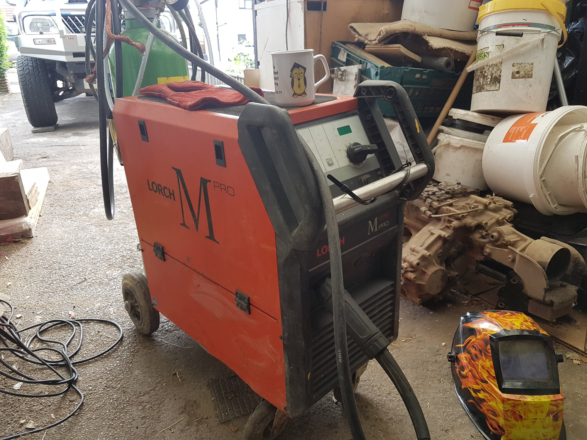

You must be putting in a tasty machine to warrant the 32amp plug![]()
The new 16 amp supply and 32 amp supply are in and ready to be used by my new to me mig. First proper proper mig I have owned or used View attachment 145384
