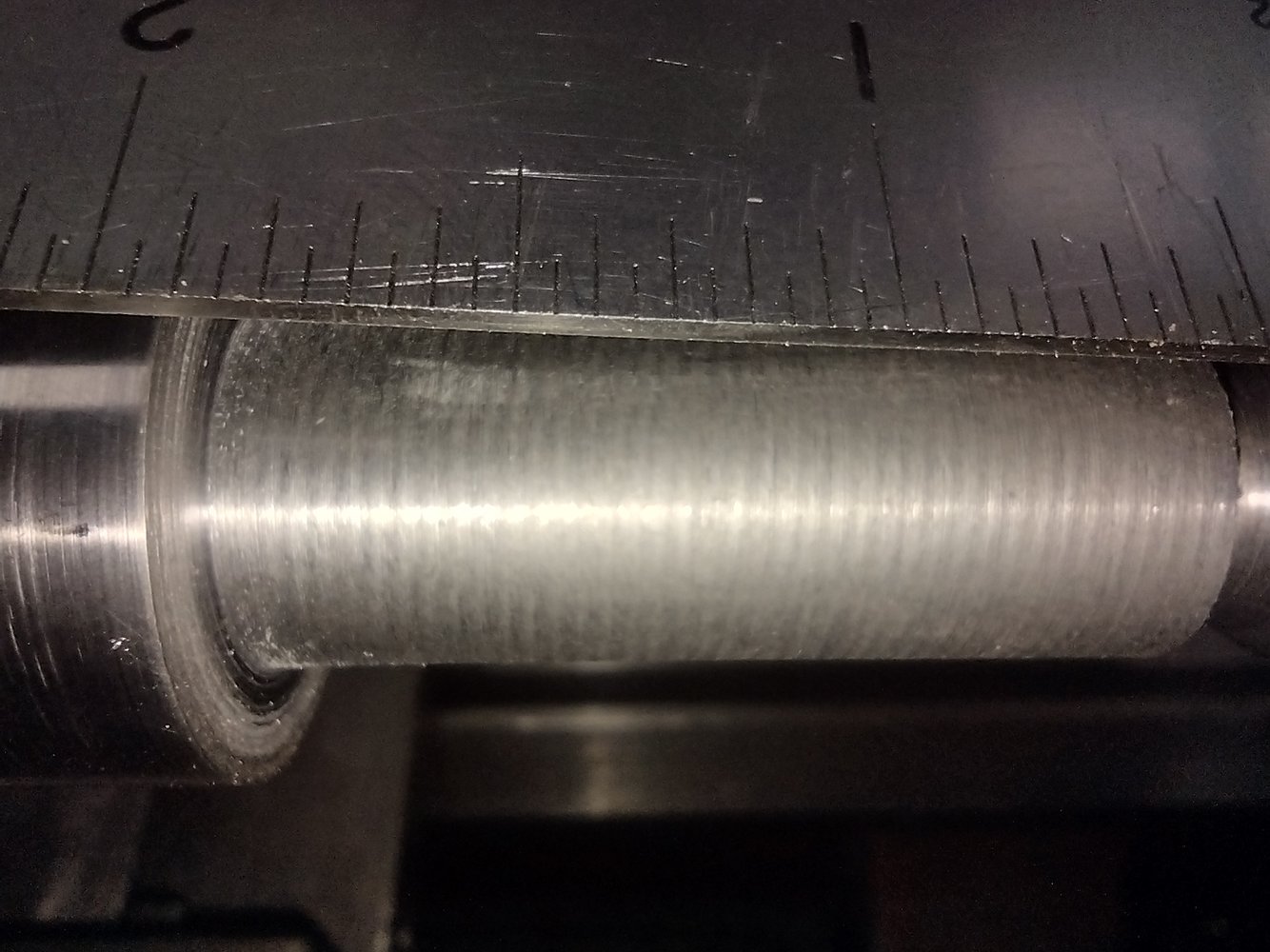

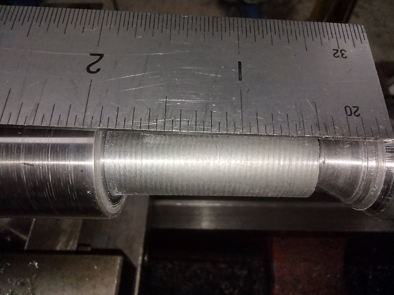

...says .032 when the spindle to powerfeed (or leadscrew) is 1:1
That chart displays nominal (rounded) numbers for the feeds. Compare the feeds shown for 2.5, 5, 10, 20, 40 tpi. In the case of feeds, this does not matter one bit, but if you did need an exact number, you'd need to be careful.
