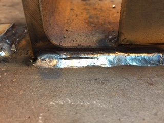

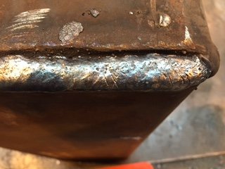

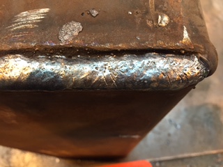

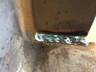

Gregwalker1981 Member Messages 112 May 9, 2017 #1 Hi Guys, can you tell me what is causing this?? 65D314FA-A361-4A33-94F1-2C8EA2F5FD73.JPG 42.1 KB · Views: 92 AB8B617E-D167-4101-8A03-31C1F626A9EF.JPG 38.8 KB · Views: 86 7D27354A-8C4F-4393-BA78-25DB3F004EA8.JPG 38.7 KB · Views: 82 19256433-3157-4FAB-87EB-CD5FF0F83D1D.JPG 35.9 KB · Views: 91
backpurge Member Messages 2,397 May 9, 2017 #2 Are you using flux cored wire, if so its down to entrapped gases escaping up through the molten weld pool
angellonewolf Member Messages 8,771 Location bristol england May 9, 2017 #3 was the work clean before starting and only to help others what metal is it galv or not
Gregwalker1981 Member Messages 112 May 9, 2017 #4 backpurge said: Are you using flux cored wire, if so its down to entrapped gases escaping up through the molten weld pool Click to expand... Yeah its flux cored wire is there anything to stop it?
backpurge Member Messages 2,397 May 9, 2017 #5 If you've got any spare material give it a clean up, no need to go mad just get the worst of the rust and mill scale off, also, are you pushing or dragging the weld
