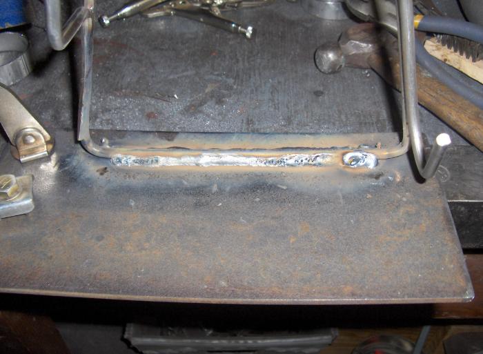

I was making  a tool  today to hold the mig gun when I want to set it down for a bit. Nothing fancy just a bit of 1/4" rod on a piece of 1/4" plate. I had the welder set at power E or in other words "Max" and wire speed at 10 or again "Max" Gas was set at 20 The weld had alot of Pitting at the beginning then it was OK  Then more pitting ??? Any thoughts ???   Jack

		 I think my problem that we are talking about now is a combination of all that has been posted. I am pretty new at welding and I don't weld enough to become proficient. Right now my main concern is to get " Nice " looking welds on my exhaust sytem for a old Hot Rod that I have been piddling around with for the last 6 years. I may just end up using the secret tool from the tutorials

   Cheers,  Jack Are you pushing or pulling the puddle?  What gas mixture are you using?  Usually cleaning it up with a grinder is enough it was probably the solvent you used the got trappe
 Are you pushing or pulling the puddle?  What gas mixture are you using?  Usually cleaning it up with a grinder is enough it was probably the solvent you used the got trappe i'll reveal my little secret...sssst! only to you Jack......the weld on the other side had such a lack of gas that it bubbled up....so i could see the weld come over on the other side...
