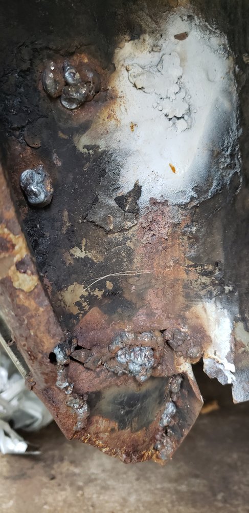

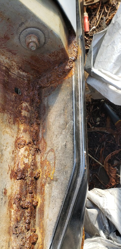

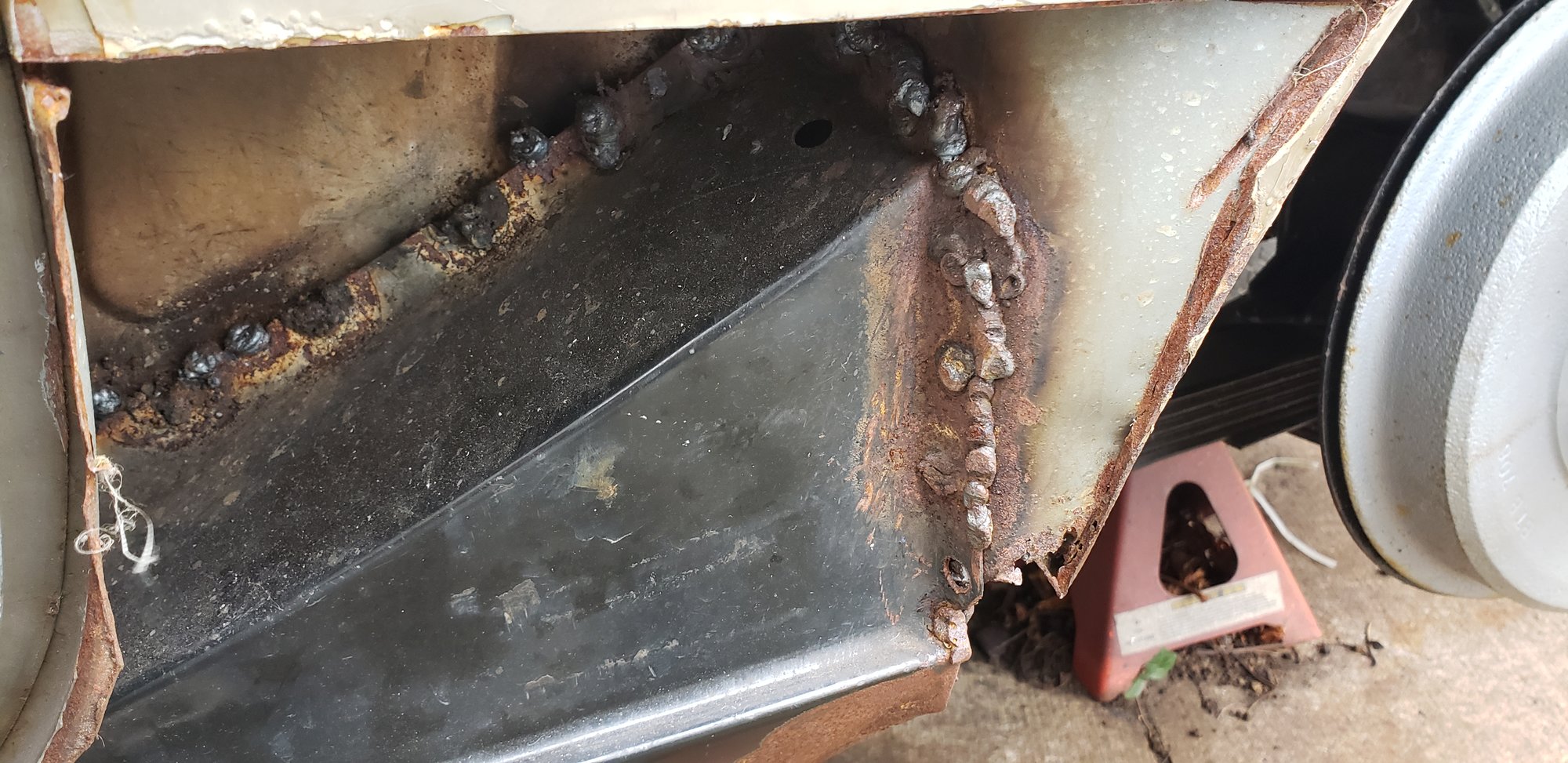

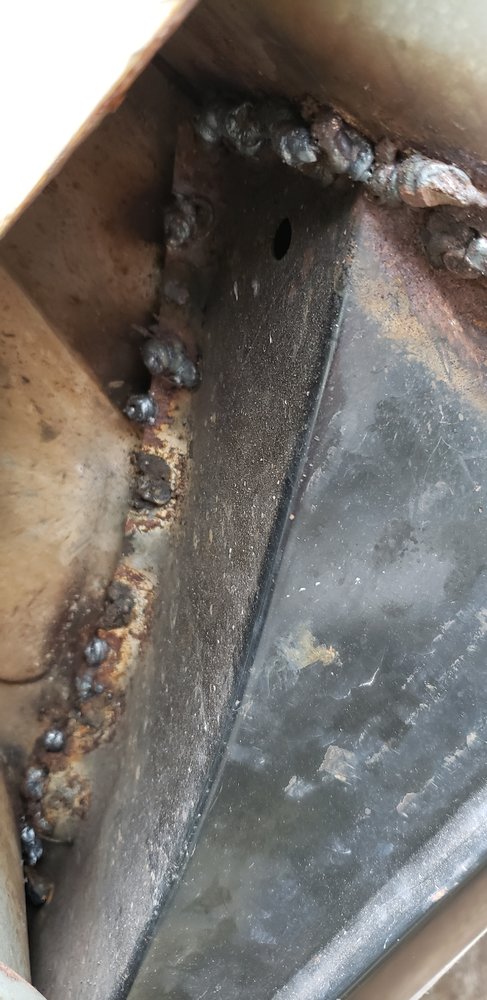

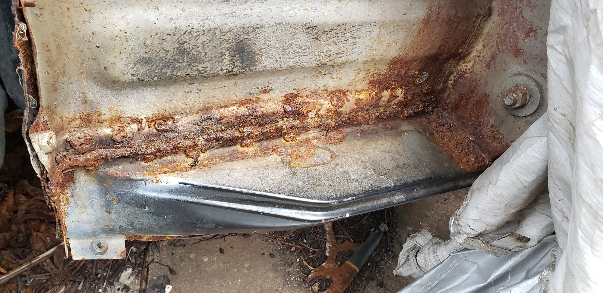

Working on an MGBGT at the moment, doing the sills on the driver's side. Popped over to the passenger side for a reference check, and found an incredible set of welds! The client is actually concerned enough about them that I am going to tidy it up for him once I have finished the bit I am doing.
The whole sill has been replaced. Mig welded, as there are bits of wire in it in places. How/what did they do to achieve this result? I am sort of impressed...
My theory is that it was too cold, as they were worried about blowing through, so just piled weld on until it sort of stuck.
