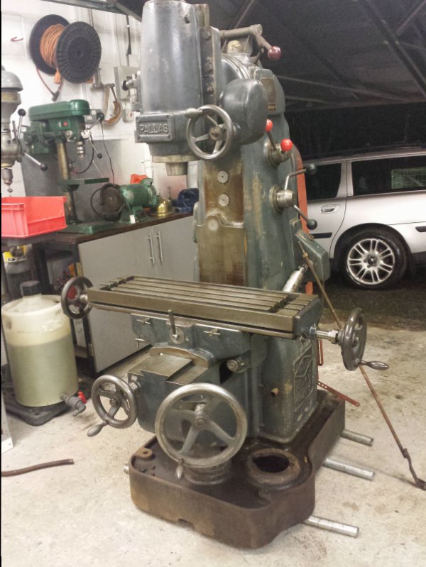

vwmark Member Messages 703 Location North Wales Jan 1, 2016 #23 Thanks. Seen both. Not much at all about on the Pallas mill and its seems a great bit of kit. Just got to get all tooling etc which will cost much more than the mill cost me!

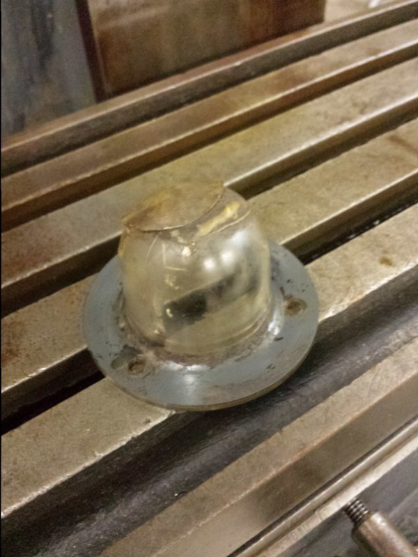

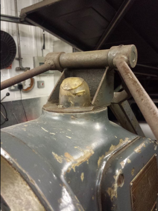

M morph Member Messages 210 Jan 2, 2016 #24 As said slurry tanker sight glasses, they are either 2" or 3" BSP male so easy to get to fit by welding a cut down coller onto the flange.
F Flathead_Dave Member Messages 325 Jan 2, 2016 #25 The old AC Delco fuel pump/filters had those.This have the spare glass http://www.flexolite.co.uk/item.asp?iID=125&cID=1&page This guy has 5 types http://www.ebay.co.uk/sch/aristilus/m.html?item=331727358400&hash=item4d3c7dc9c0:g:skwAAOSw8-tWZexI&rt=nc&_trksid=p2047675.l2562 You can see how they clamp on here http://www.ebay.co.uk/itm/Fuel-Lift...095636?hash=item3a7e6bc6d4:g:LLQAAMXQmWdRHNYj
