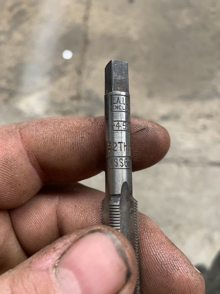

Figures, it is plessey after allProbably a special, it was common back in the day. Make a special thread and people had to go to you for parts.

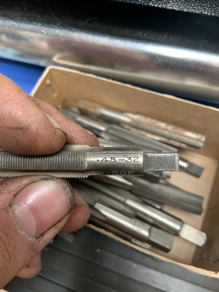

.450 dia, 32 tpi? Gun threads would be my guessOh another one does have, “.450 x 32 Thrds - Whitworth”
I hope he is, I like an unusual thread size! .......it may have to be by pm though.450 dia, 32 tpi? Gun threads would be my guess

Plessey used to make missile components and torpedoesArrow head is War department.
RGF = Royal Gun Factory possibly?

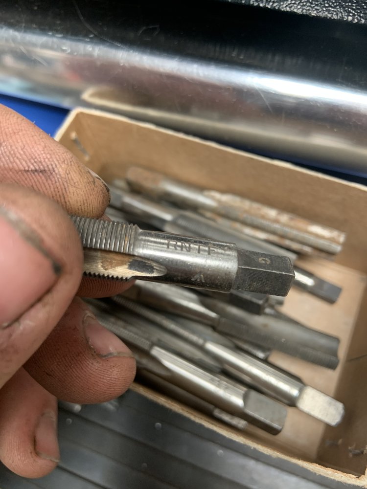

You’re probably bang on the money plessey used to make torpedoesThe crowsfoot/broadhead marking and RTNF (perhaps Royal Navel Torpedo Factories) could be a clue to their origin and vintage.
Tried checking against a thread gauge?
Guns were ROF...Arrow head is War department.
That’s the bit my dad was involved with. I’ve nothing from that time of his that really gives much away I’m afraid but I’d think the above is pretty spot onPlessey used to make missile components and torpedoes![]()
Guns were ROF...
