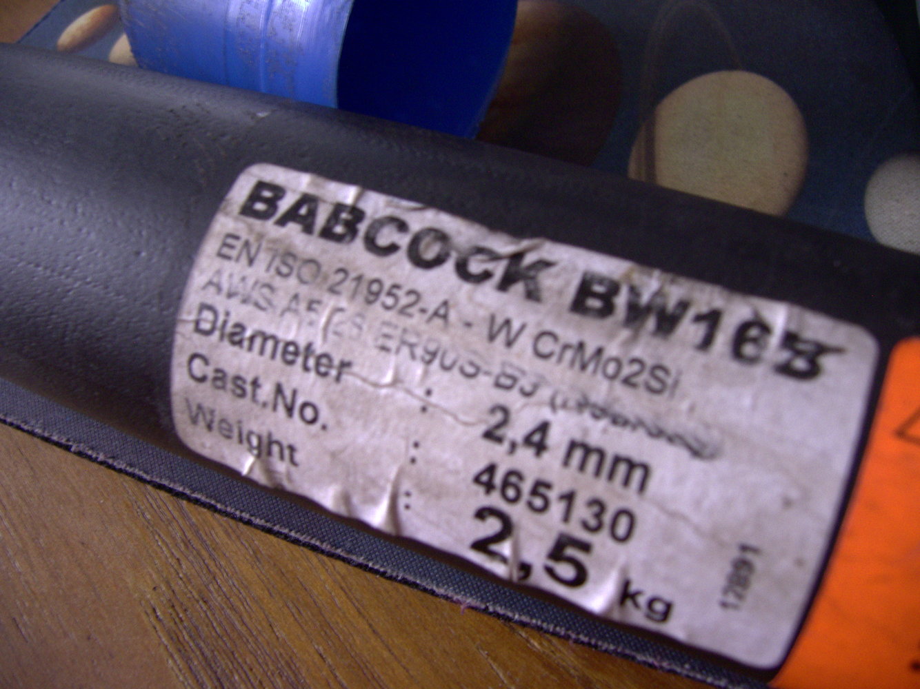

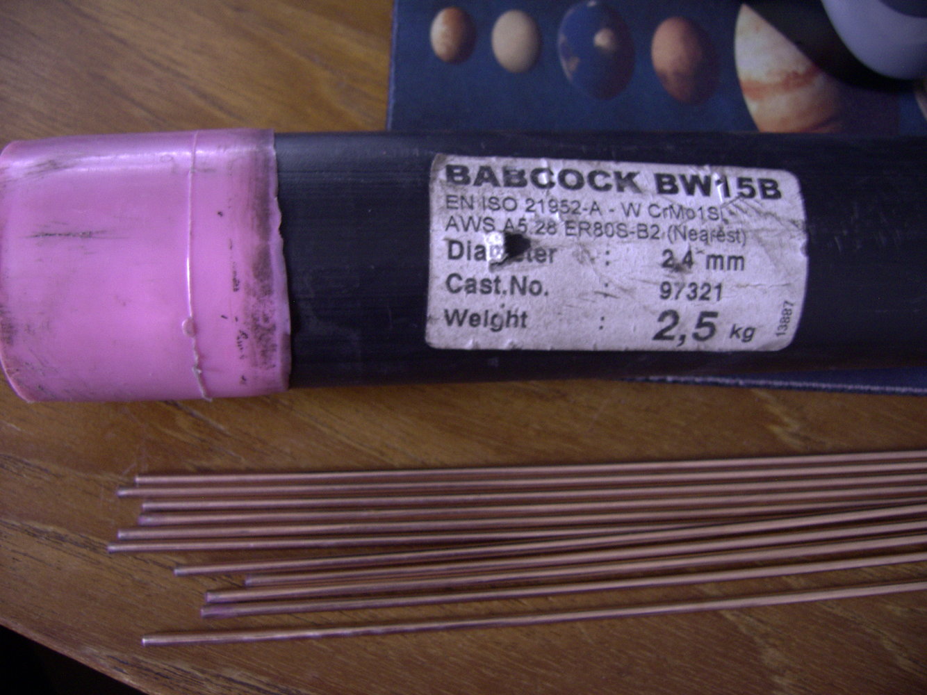

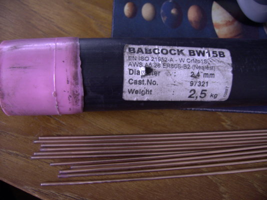

Top marks to that manChromemoly going by the label
Cross posted.thats it Chrome Moly...............2Cr1Mo.......usually used on steam pipe in power stations
If its nothing critical you could use them on mild steel....they will harden quite well so maybe they could be used to put an edge on mild steel.....900oC and quench to harden
