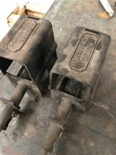

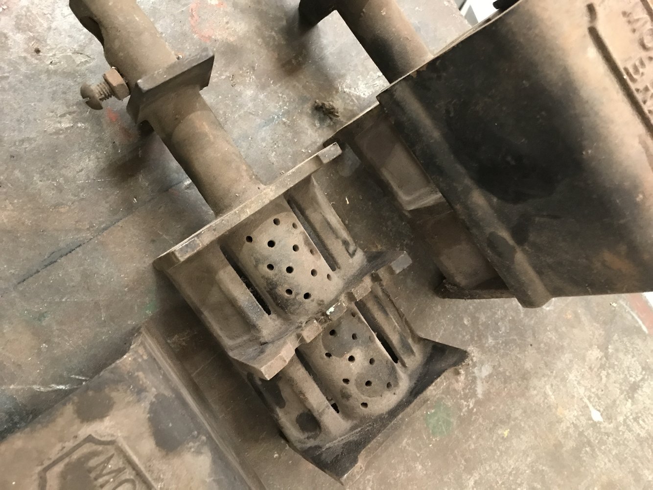

They aren’t very long, maybe 4-5”. Don’t think you would have much joy balancing a bucket on it. The lid part intrigues meSean similar for tar melters and keeping the tar buckets on.
Very common in the 1960's to 70's
The tar/pitch bucket sits on the lid.They aren’t very long, maybe 4-5”. Don’t think you would have much joy balancing a bucket on it. The lid part intrigues me![]()
yep for soldering irons big copper ones cable jointers used them on underground cables and we had them at schoolI remember those from school in the Junior Metalwork Room for heating up soldering irons.
Not seen one for over 45 years. Jeez I’m getting old!
When I think back to what we used to get up to in the metalwork lab, I'm quite surprised we managed to reach middle age.I remember those from school in the Junior Metalwork Room for heating up soldering irons.
