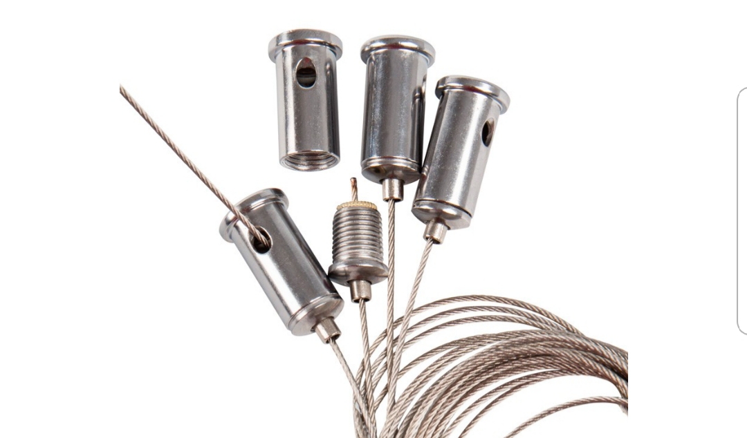

A Aesgarth Member Messages 543 Jun 16, 2020 #1 The cable gets pushed through the middle but doesn't pull back out unless you depress the button to release it. Trying to find out what these are called...
500e Always buy fire insurance a flood is a hard start Messages 9,236 Location South West Jun 16, 2020 #2 We have them on our pneumatic survey masts, But rope rather than wire, Clark just call them guy tensioners This style of thing https://mgs4u.com/product/guy-rope-tensioners/?v=79cba1185463
zzr1200 Working at 650 ft on open steel work. Messages 6,328 Location Glapwell, Chesterfield, Derbyshire, UK Jun 16, 2020 #3 Gripple. https://www.gripple.com/products/building-services/unigrip-central-exit/ Hth
brightspark Member Messages 41,250 Location yarm stockton on tees Jun 16, 2020 #4 these any good https://www.ledkia.com/uk/buy-led-p...VyLHtCh12mgrPEAQYAyABEgI0m_D_BwE&gclsrc=aw.ds
A Aesgarth Member Messages 543 Jun 16, 2020 #5 brightspark said: these any good https://www.ledkia.com/uk/buy-led-p...VyLHtCh12mgrPEAQYAyABEgI0m_D_BwE&gclsrc=aw.ds Click to expand... Pretty sure that's where I stole the photos from. Thanks! I have a few of those already, was hoping to find some slightly larger ones.
