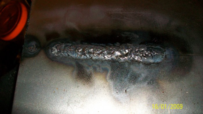

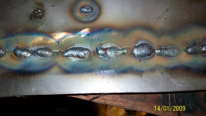

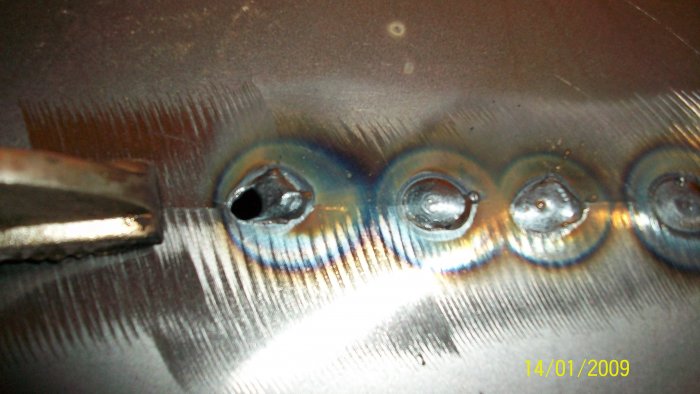

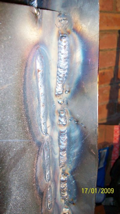

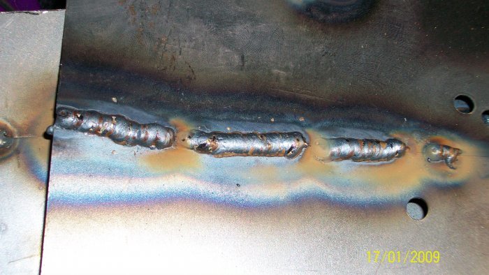

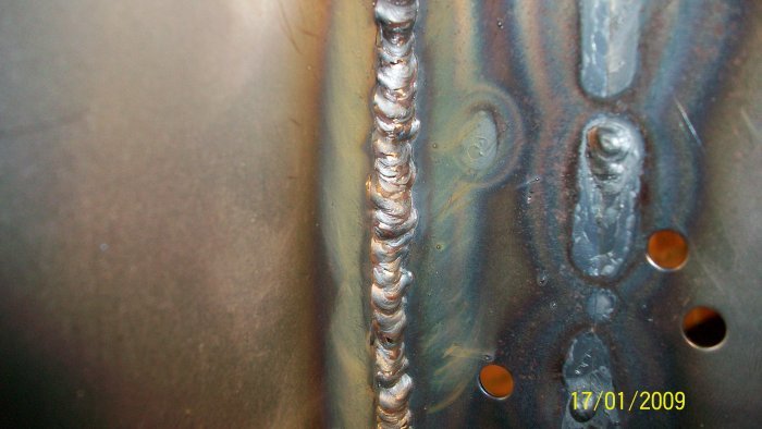

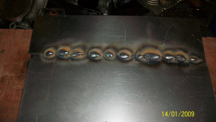

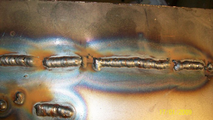

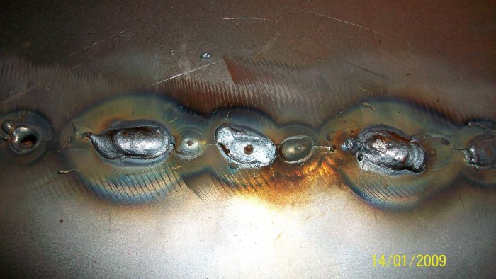

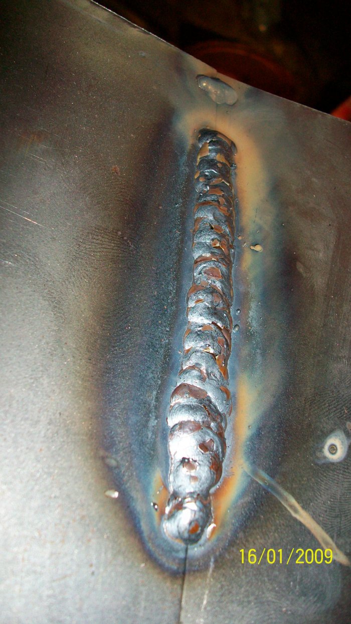

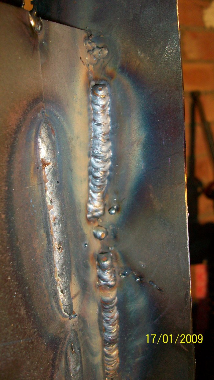

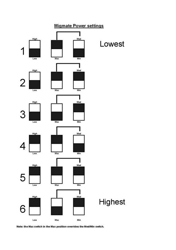

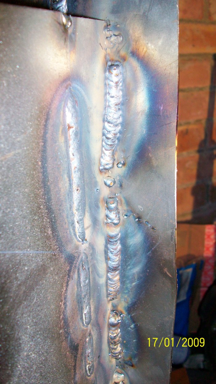

yes i was pulsing he triger i kept blowing holes in the metal i thought i was on the lowest power setting but now i dont know if i was or not . i thought that my welder only had 3 power setting sput now i now it has six. how do i stop the weld being lumpy ?
