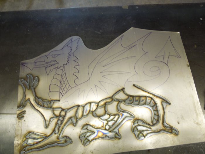

I was recently contacted regards making somebody a wall mounted Welsh Dragon. Jobs might be in the bag, not sure but I decided to have a go anyway. Figuring there are a few patriotic welshmen out there and I liked the image.
So I scaled it up to 125cm long and drew it on a sheet, then began welding the lines to define them.
Looking promising, then I left my camera at home for a couple of days.

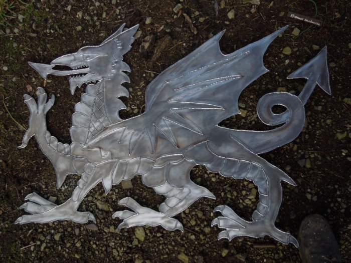

Here it is cut out .

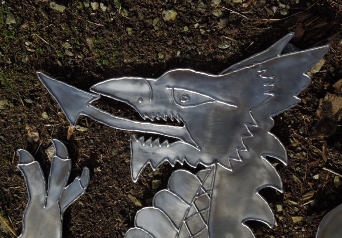

And a detail shot of the head.
Plan A is to mount it standing about 70mm proud of the wall. I have welded a structure of strip edge on underneath to stiffen it, the body is made of 1.6mm mild steel.
Now lets see what my customer makes of it.
