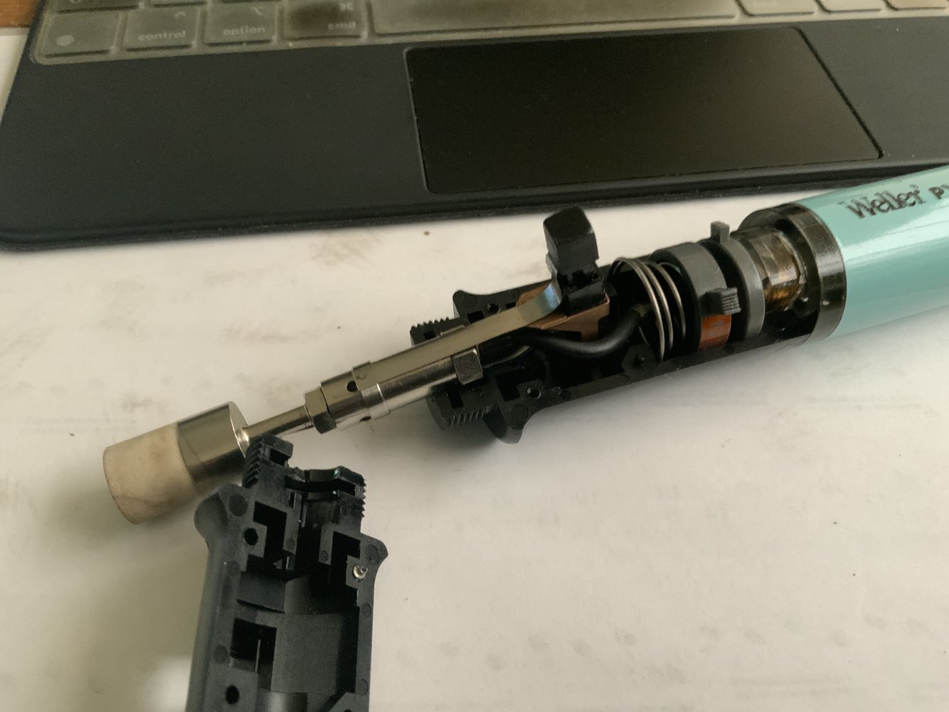

Its had that in the past.Surely it just needs a bit of judicious bending![]()
. Needs some TLC this timeThank you. I'll give you a nudge on Monday.I MIGHT still have one that you can have for spares. I got sick of it, having already had it serviced by Weller yet it still overfuels regardless of the setting. Remind me to look in the office Monday if you would like it.
You can lite the end but that doesnt energise the ceramic to give hotair.The early Portasol irons didn't have a built-in ignitor, there was a flint "lighter" in the cap, if that packed up I would light it with a normal lighter, that may work for yours?.
Its a hit and miss affair doing it that way. PITAOK, it must work different to an iron then, I would just put a flame near the catalyst port to light it.
