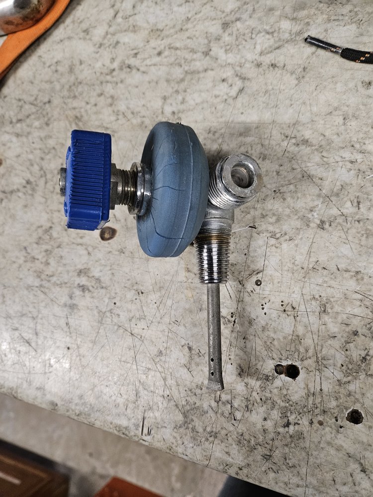

Took one of the 136 bar tank valves off to figure out the threads, the outlet thread took a while as all dimensions matched up to 5/8-14 bsp AND 7/8-14 unf but I'm going with bsp being British made equipment (probably anyway)

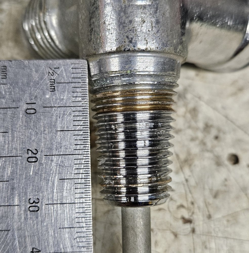

The taper is a whole different nightmare as 14tpi is only part I can work out and it's roughly dropping from 0.78" to 0.63" over 0.9"
