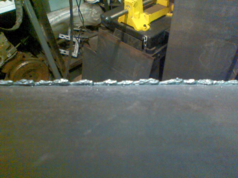

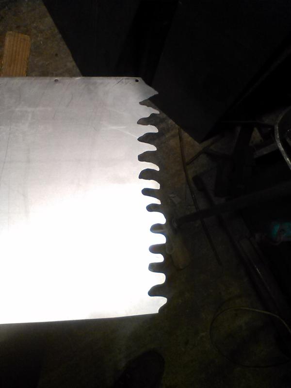

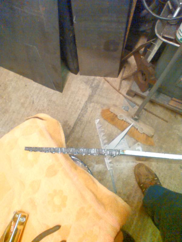

The main reason for getting it is to save time and my ears and general mess in the garage rather then using slitting disks in the grinder Had the obligatory play with 1.5 mm aluminium sheet some 2 mm zintec and the 3mm plate all OK down on 20 Amps and running about 45 psi, which I think may be a bit low. The gauge is in Mpa and kgf/cm^2 so I did a guess at the air setting.
Three pictures, first of the alluminium cut, very quick and clean. Then two of the 3 mm steel, showing the kerf, which was easily removed with a flap disk, but I think a bit more air pressure may reduce it a bit.
