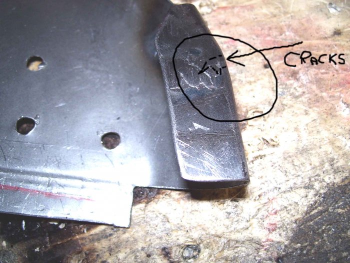

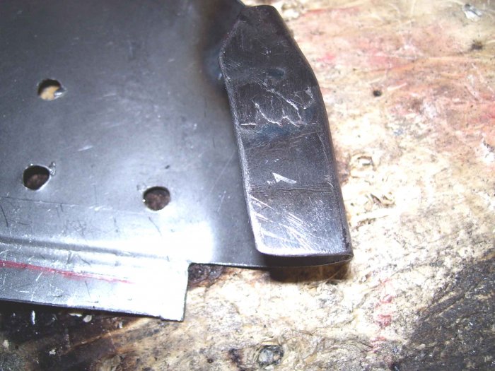

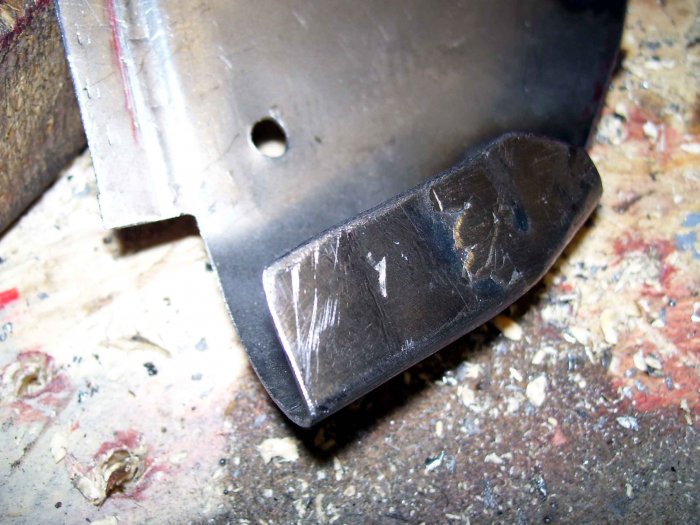

If you need to grind it back flush, run the edge of the disc along the 'crack'/non weld, to create a Vee, then weld it - hotter this time. At least when you grind it flush there will still be weld metal there.
Yes, good idea!! i've repaired a jig for one of our big presses like that last week!
(economic crisis!! i find myself welding up broken stuff a lot lately in our plant...
Hey! if it works on a 500 tonne press, it will work on your car too!
