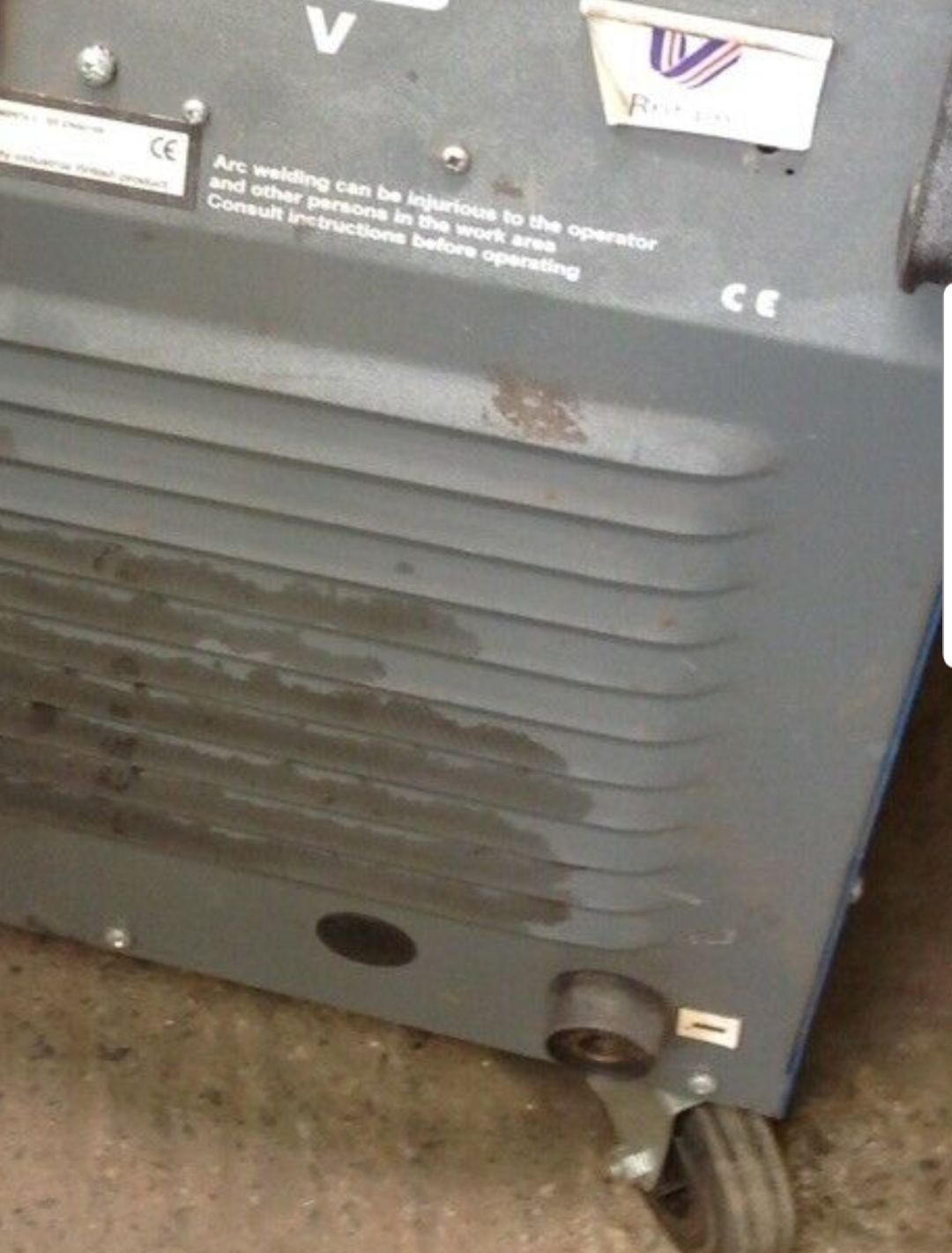

A Adam Marshall Member Messages 489 Location Nottinghamshire England Sep 8, 2019 #6 Thanks for all replies, my mig has dc - but no dc + and I'm sure it needs to have dc+ for this wire doesn't it, my welder has a socket for dc - but next to it there is a cap where + should be but no socket
A Adam Marshall Member Messages 489 Location Nottinghamshire England Sep 8, 2019 #8 This is how it looks Screenshot_20190908-211615_Chrome.jpg 577.8 KB · Views: 80
A Adam Marshall Member Messages 489 Location Nottinghamshire England Sep 8, 2019 #10 So does that meen I still need to get it sorted to use 15.14 wire?
