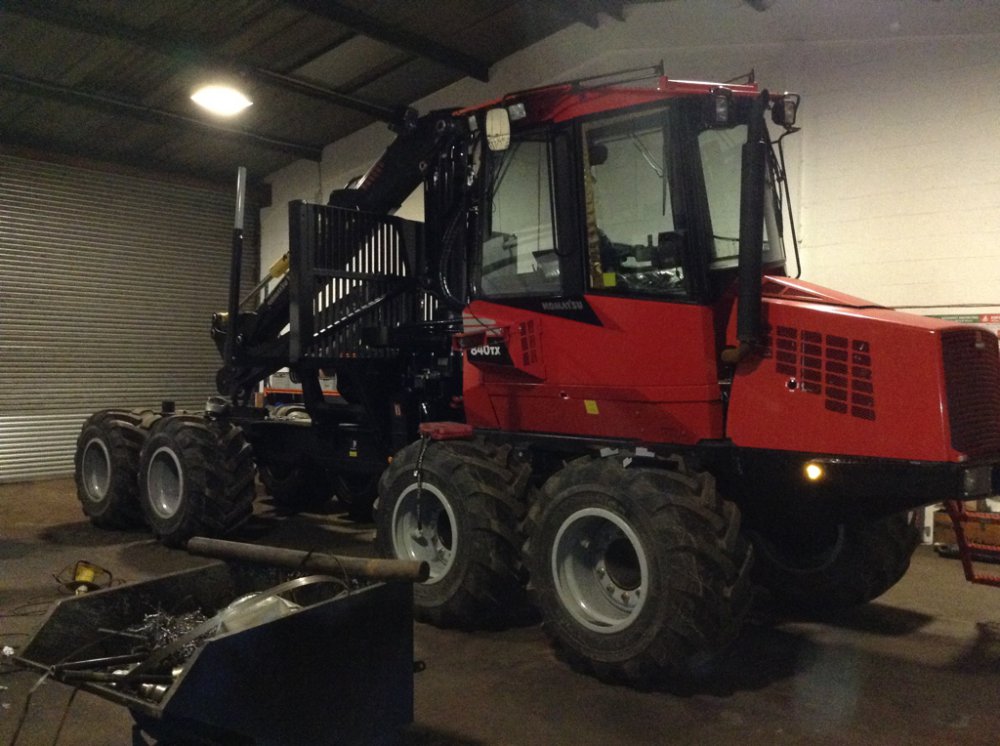

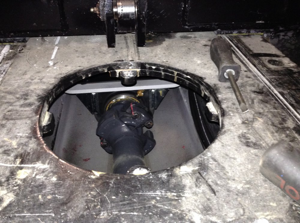

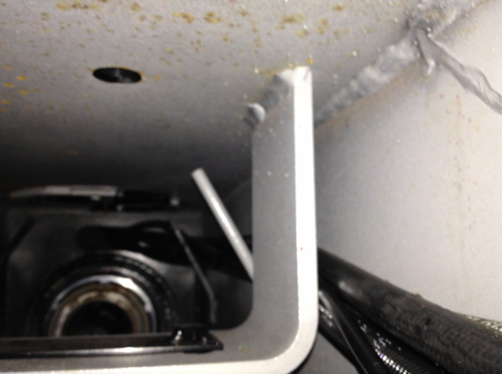

Had a machine came in that had broke the bracket off that carries the propshaft bearing. It had just been tacked on and must of been forgot about at the factory. Surprised it lasted as long as it did. It was a nightmare to weld because I could not see it!! Had to use a mirror to be able to weld it but everything was the wrong way round. Managed to get it done, not pretty but its still working.
Not the actual machine I had to do (had no time to take photos) but it gives you something to show what I was up against.
