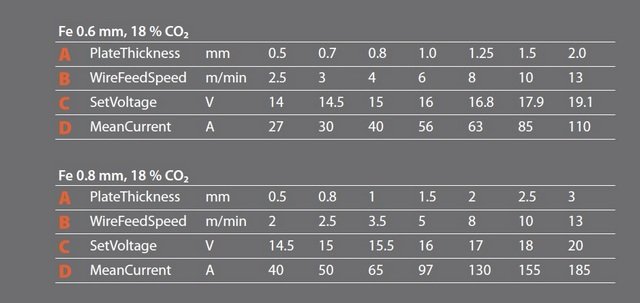

I had a play with my new welder today (great fun)
We're my old mug just had 1-7 power settings and wire speed.
My New one has digitized screen with the volts on it.
So I was wondering if any had a chart with basic volt ranges for different thickness metal like the welding calculator on the forum.
