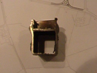

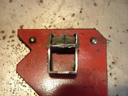

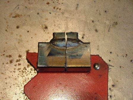

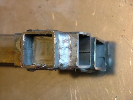

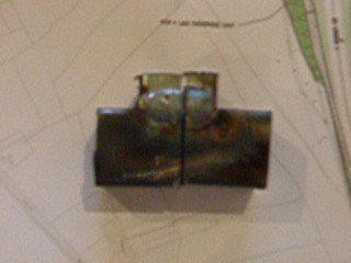

I've been playing around with welding 16swg tube in advance of building a Locost. Here's a couple of pics from today - I don't think I'm getting quite enough penetration - could this be because I'm trying to do it using 0.6mm rather than 0.8mm wire?
Sorry for the slightly poor pics - if anyone can tell me how to do good pics that might help too!
