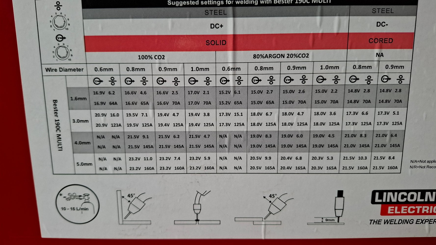

I consider myself very much a beginner, and I'm struggling to understand how to correct a frustrating problem. I'm MIG welding a patch I've made from 0.9mm cold rolled steel onto my MK5 Golf (sill repair).
I've been attaching the patch (butt) using tacks and filling in the gaps, a tack at a time. The problem I'm having is that a good percentage of the time I get a flame between the tip and the panel and no puddle. I'm running the welder pretty low. It's a Lincoln Bester 190c running 0.6mm wire on CO2. Wire feed is around 4 (almost at the minimum) and the voltage is between 13 (minimum)-15v (I keep tweaking it). The welder also has an induction setting which I've got almost maxed out.
I'm trying to avoid blowing the edges of the patch/car body, which is the other issue I keep having.
Is the flame due to a voltage issue or something else?
