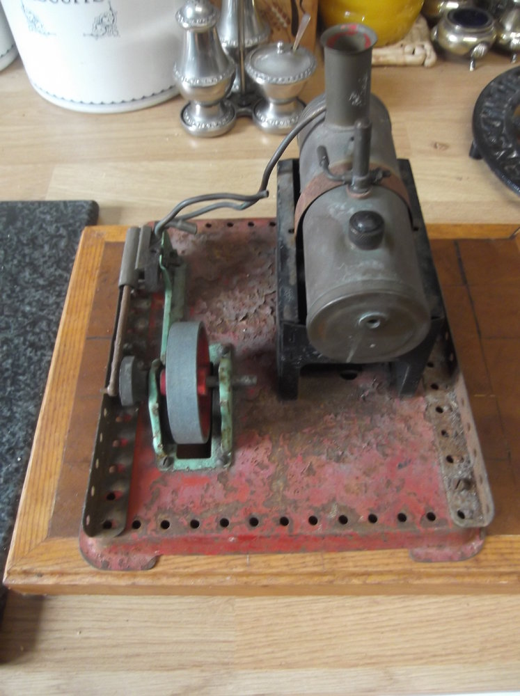

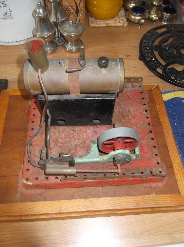

This engine came my way the other day. I know it needs a lot of work. But being a "Transit" design. One designe between the flat base and the steped up base it is worth trying to save.
But theses bases are prone to cracking on the mounting points.
This one has a serries of cracks. To stiffen the base some one has bolted on Meccon angle plates. This was some thing Mamod approved off.
But in the past I have tried to fix the cracks.
By:
Mig.
Brazing.
Plus some tried tig on the plates.
No matter what I have tried the repairs stand out or do not work. New cracls form or the olds ones start up again.
One answer is get a new base, costly, had to find and removes the orginality from the engine.
Does any one know of a method that will work and not stand out?
