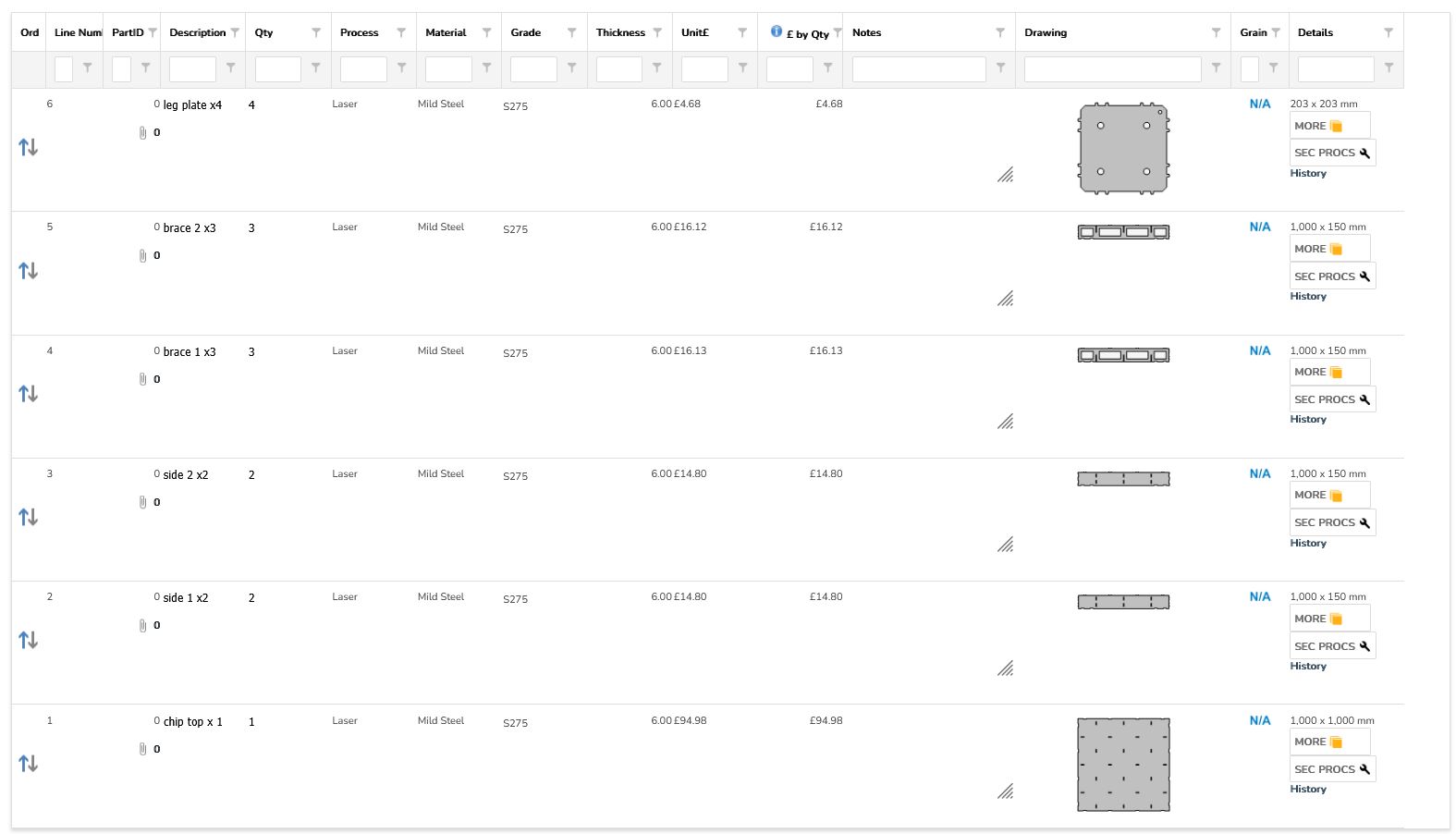

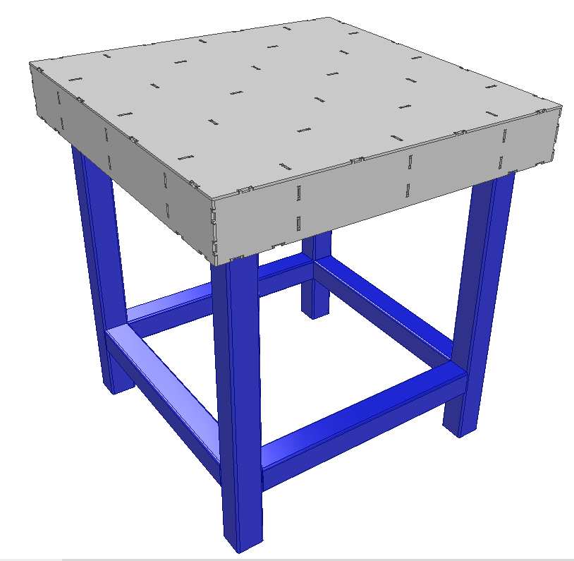

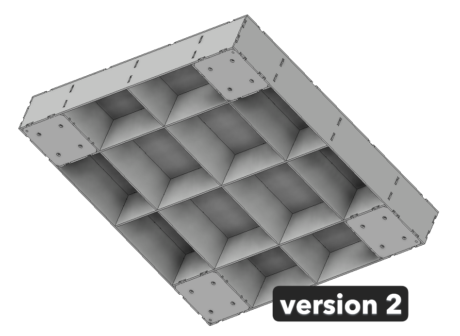

Watching this with much interest. i could use more than a small plate. but is 6mm thick enough for a welding table? most seem 10mm+
