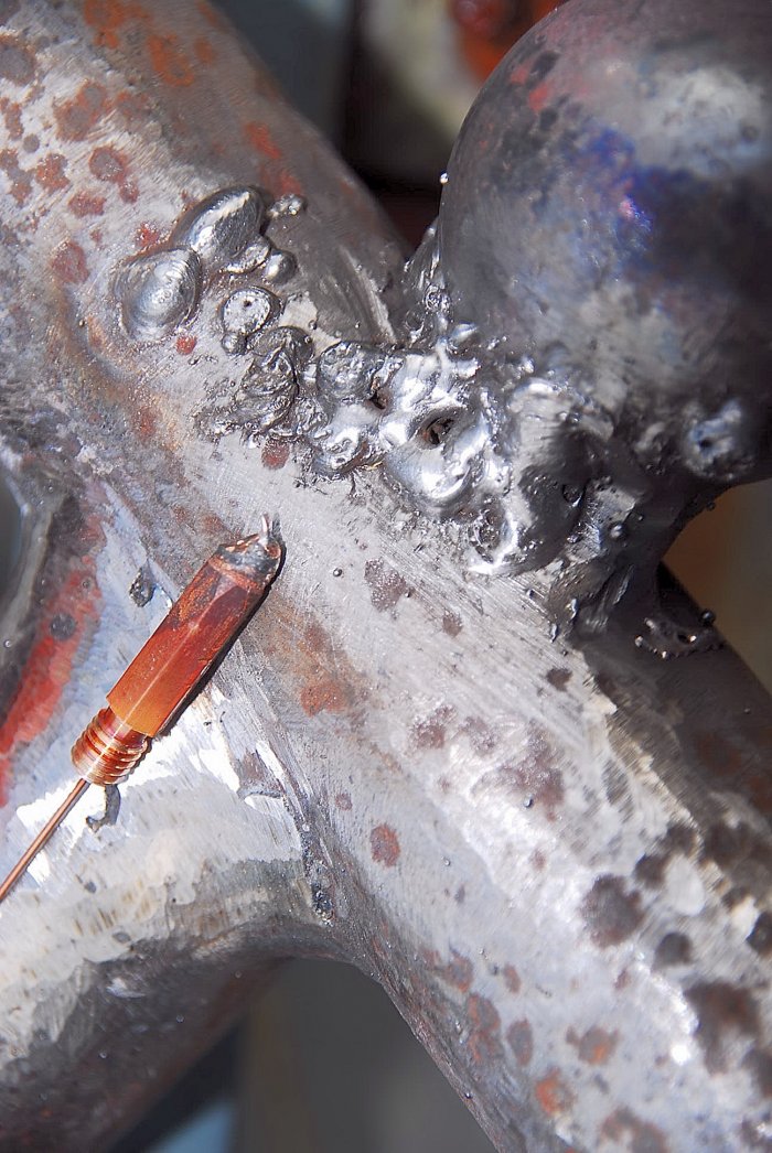

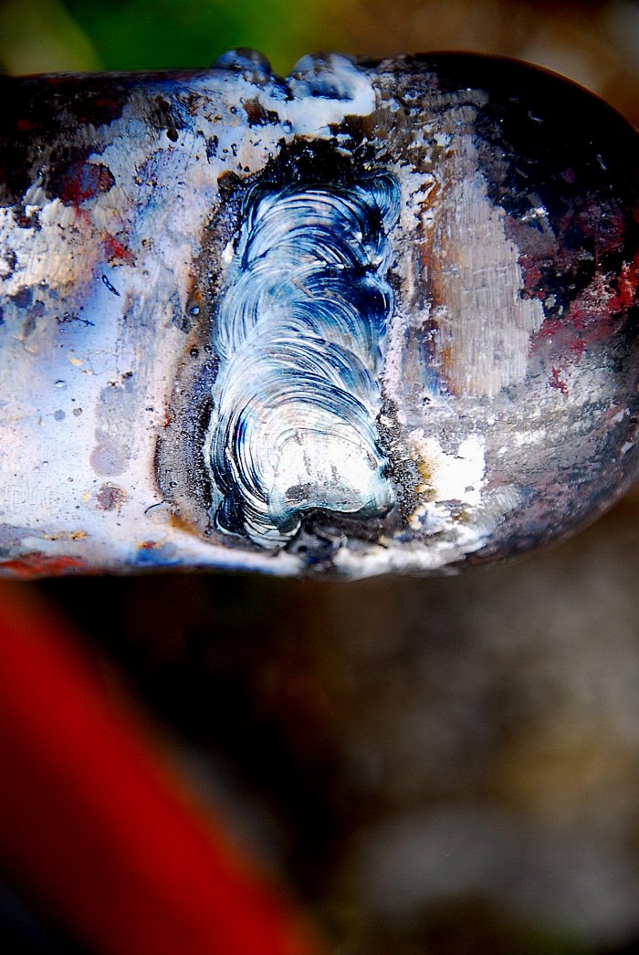

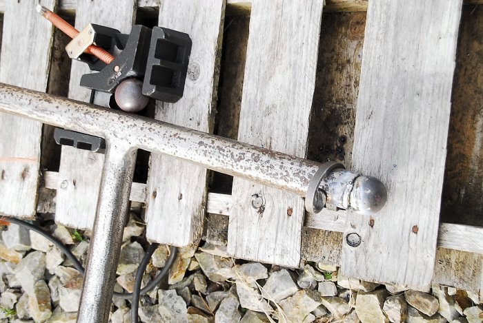

The sip welders clamp does it again but still not sure how to make the ball stick properly due to the difficulty experienced welding the balls on to the ends which should be easy but is proving just as difficult as welding the poles together . I have a 180amp mig welder available and am beginning to think it may have been easier using this rather than the mma invertor , I just thought as it was thicker metal that mma was the right way to go but seems I can blow holes in any thickness of metal . The second main problem has been the need for a number of layers of weld and the problem of grinding the slag inclusions back to clean metal before starting a new layer as I have found that you cant just weld over the top of them as you end up with a deep trench of slag thats even more difficult to get rid of . Is there a correct way to weld the balls ?
