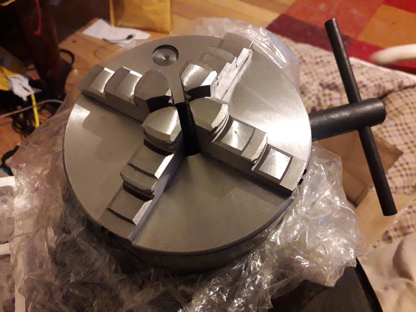

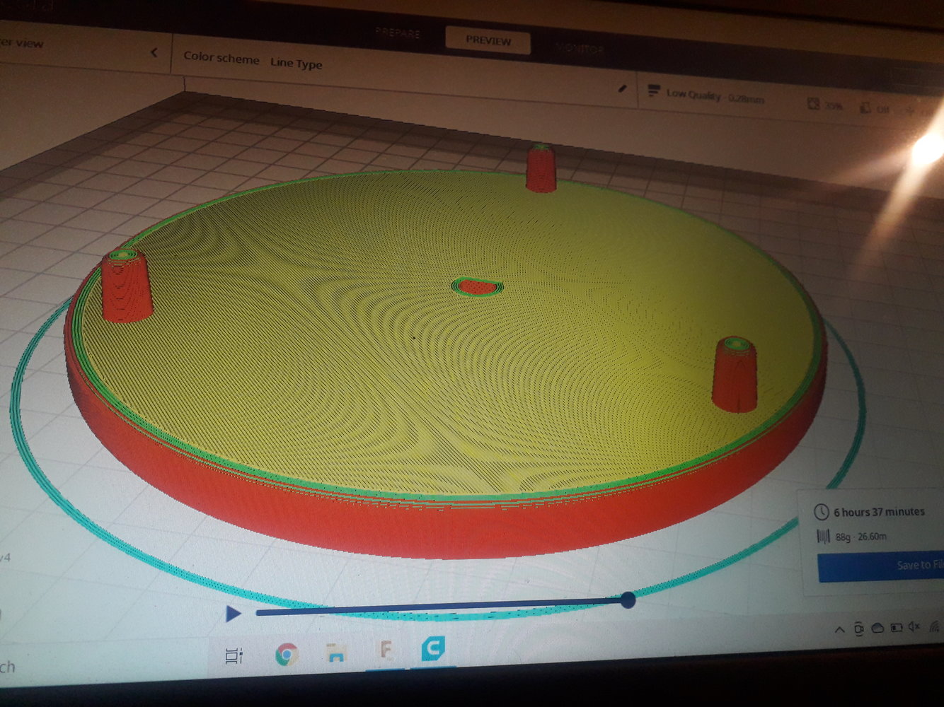

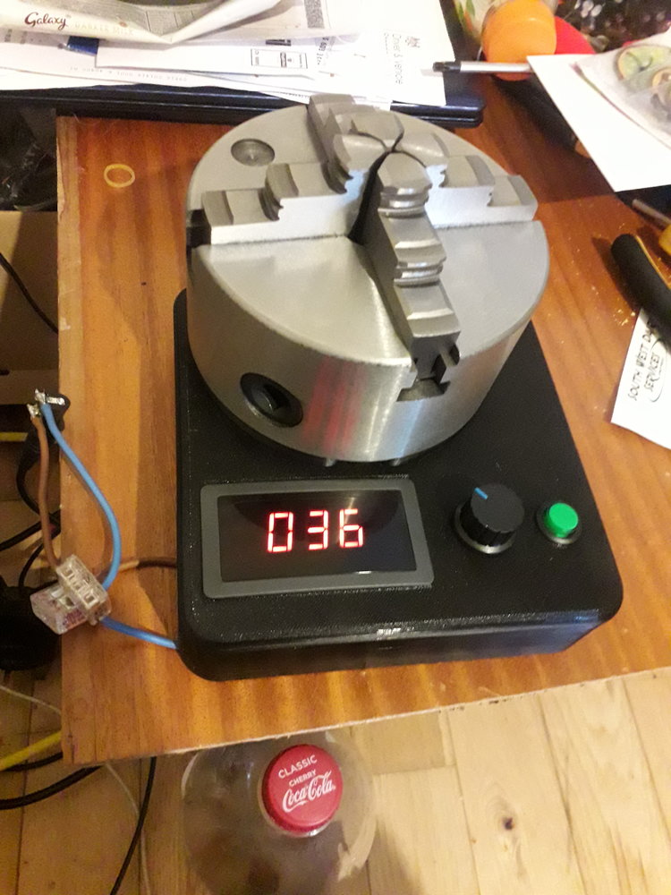

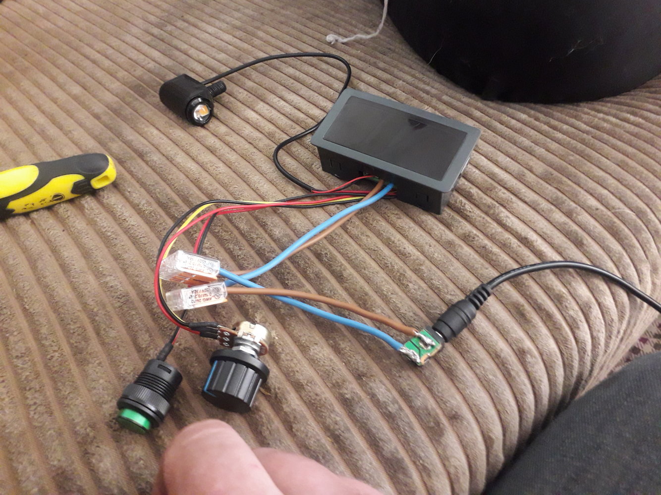

Well guys I thought I would put this up as a little project I'm doing.
Relatively basic design to keep it as easy and simple as possible. I looked about buying one but even the cheap Chinese ones were circa £200.
12v power supply which already have. 12v speed controller (£5) 12v worm drive gearbox motor (£10) 4 jaw 125mm chuck (£17)

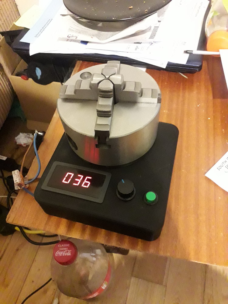

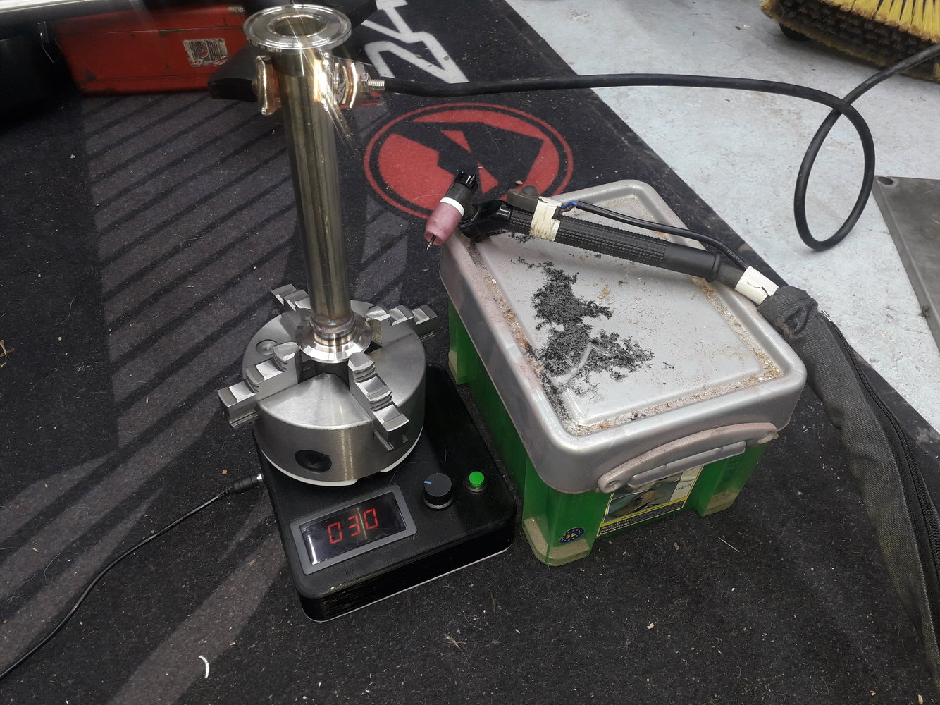

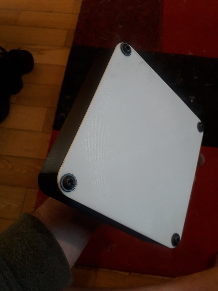

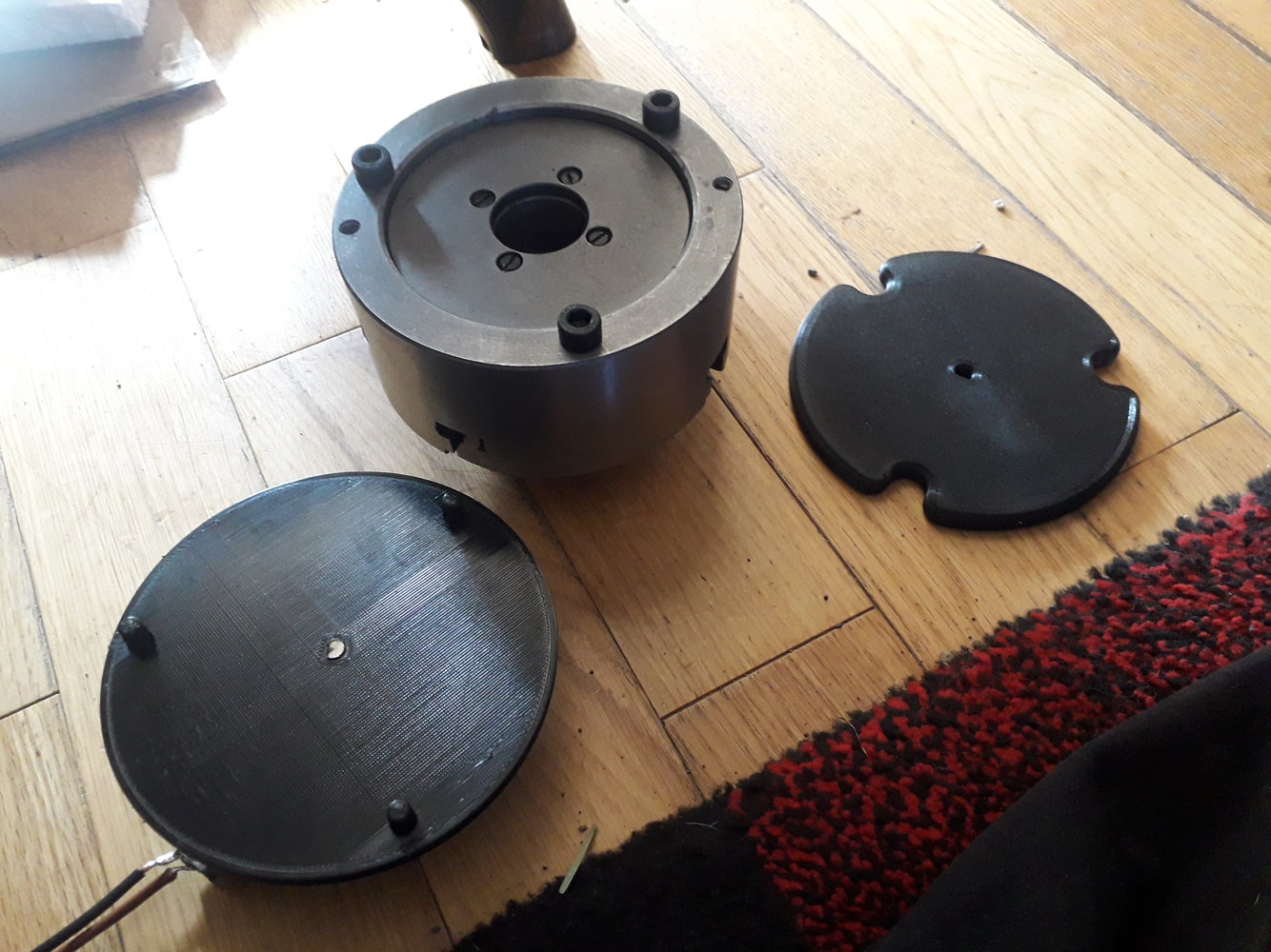

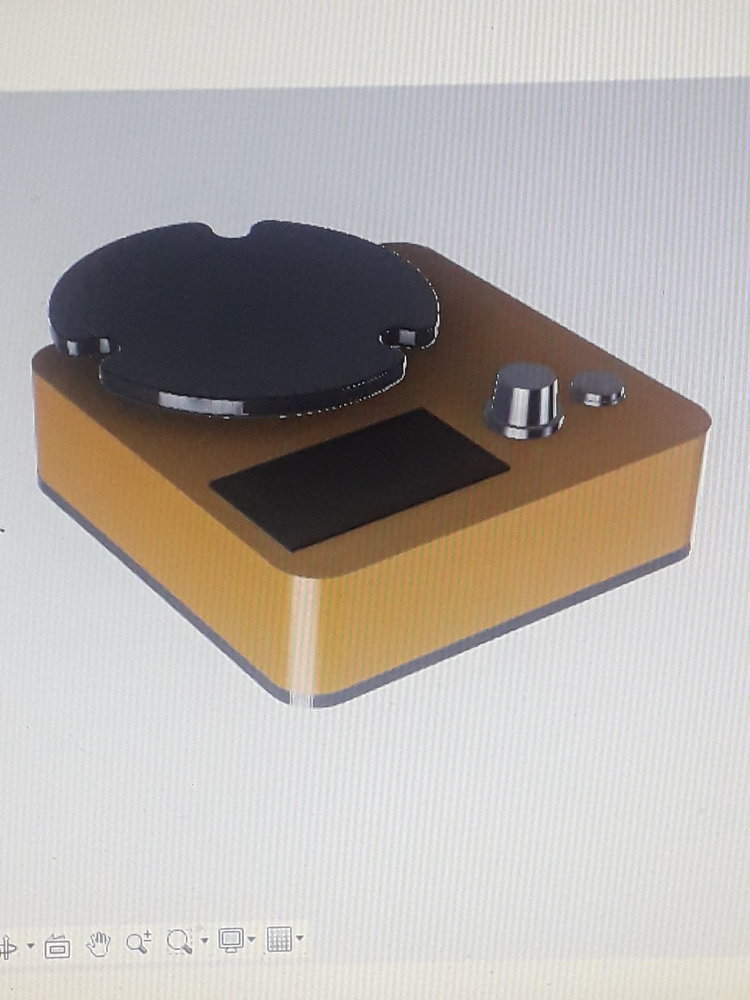

Now that have done the test spins I am happy to progress and make the enclosure for it.

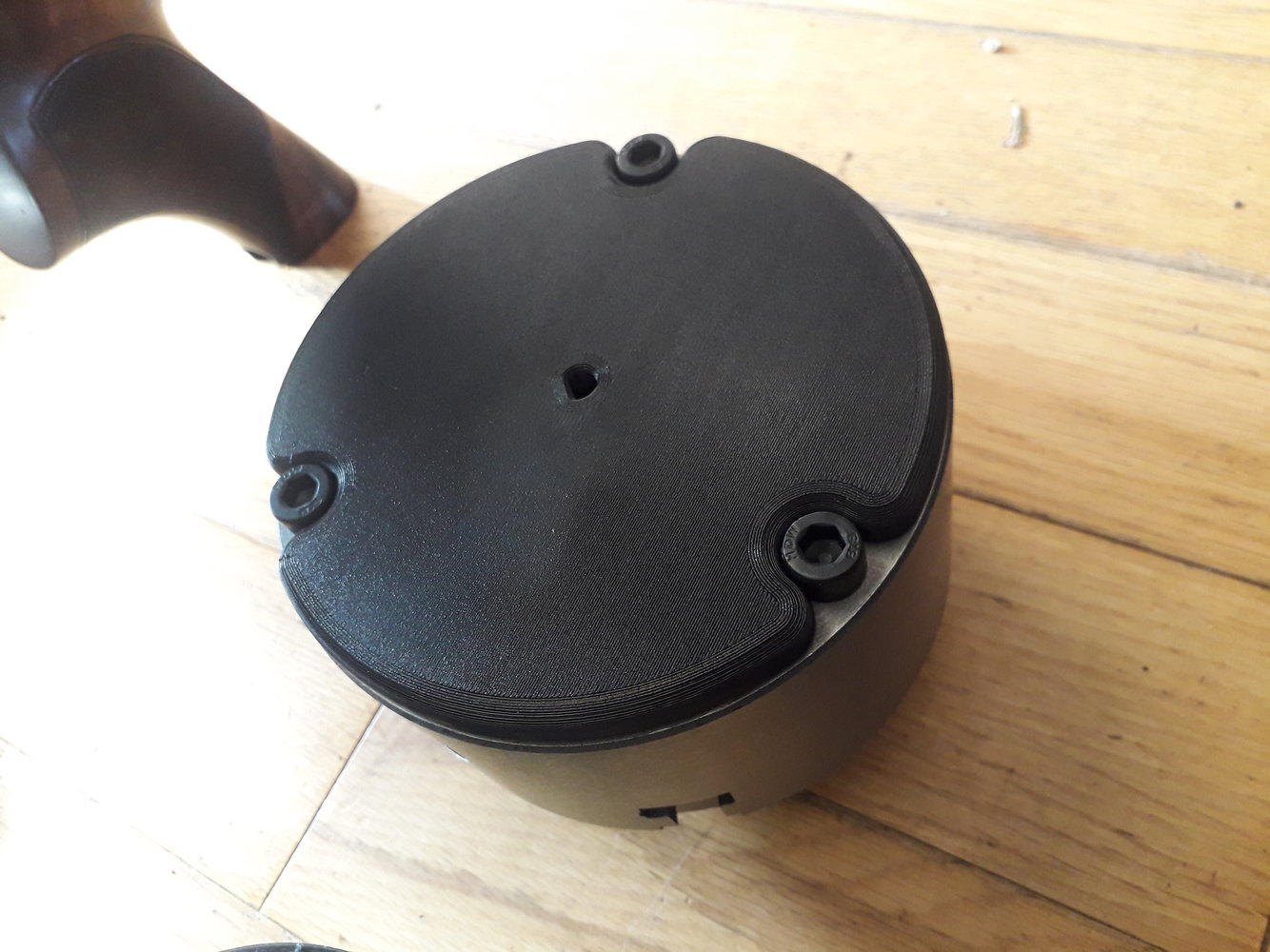

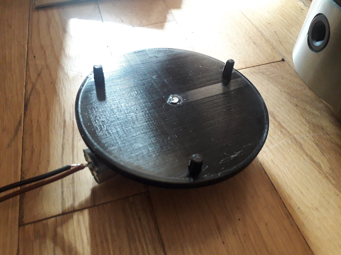

So I'm happy with how its turned out so far. Just got the fab the connector between chuck and the motor and probably put it on a bearing to support the load.
