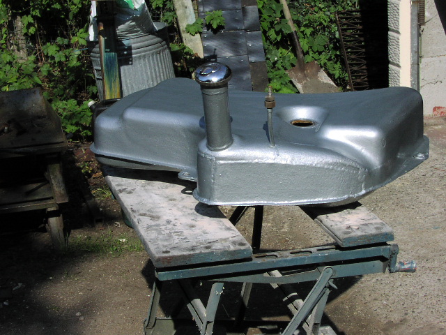

I want to move the brackets on a fuel tank for my shogun raising it by about 2 inches. The tank has been empty of fuel for 3-4 months and i have flushed out with water. I am going to flush out again with water and washing up liquid and with a steamer.
Im planning on cutting the existing brackets and adding in a piece of 5mm plate. I have scored a line for where im planning on cutting which you can see in the photos.
I am planning to have the tank filled with water when i weld and do it outside.
Am i taking enough precautions or can anyone advise anything i can do reduce the chance of it blowing up?
