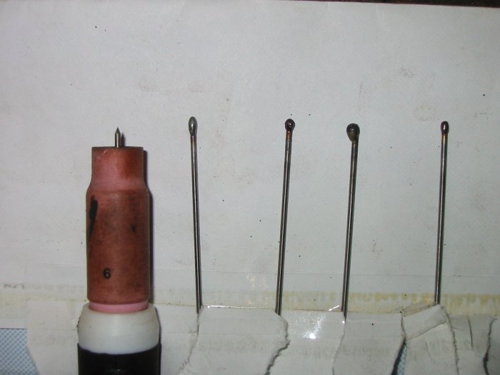

Hi all,
I have been testing the "steep" part of the learning curve for my new TIG welder. I have sharpened a couple of tungstens and been practicing on some scrap mild steel of various thicknesses from 1mm to 3mm.
I have set up like this:-
1.6mm ceriated tungsten, no. 6 ceramic and about 6 lpm argon, 45 to 50 amps DCEN for the thicker stuff, and
1.0mm thoriated tungsten, no 5 ceramic, and 6 lpm argon, 30 - 45 amps DCEN for the thinner stuff.
The tungstens were sharpened to about two and a half "diameters" on the cone angle. Tungsten tip projection was almost as large as the size of the outlet hole of the ceramic nozzle (about 6 to 8 mm).
The problem is that I keep getting the tips of the tungsten "balled up". The ground points don't seem to last more than 15 minutes before turning into a lollipop, and needing re-grinding.
Am I missing some important point in setting up my machine? I have it on DC, and have tried the "pulse" function, but I am still doing a lot of grinding.
How long would you normally expect a tungsten to remain pointed if you were DC welding with one? Is there any rule-of-thumb technique for keeping the point on a tungsten?
Any advice welcomed...
Cheers,
Rob
