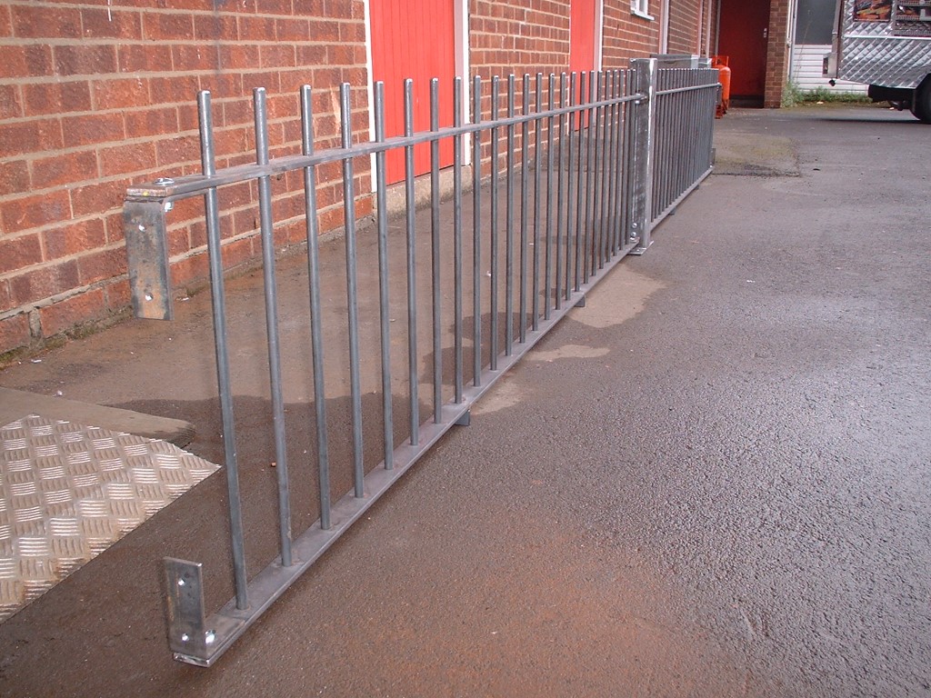

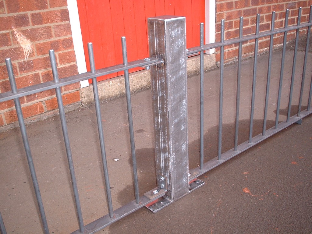

I’m making a 700mm high metal fence with 100 mm spindles with predrilled flat bar too and bottom. Question do you think I can weld underside of the flats, so know welds visible? I plan to Power coat after.
Have you any links to places that do this? I’ve never heard of it.They do powder galvanising and have for years and you can powder galvanise and cure it at high temperatures and then have a second powder coating in your preferred colour and this is cured at a much lower temperature.
