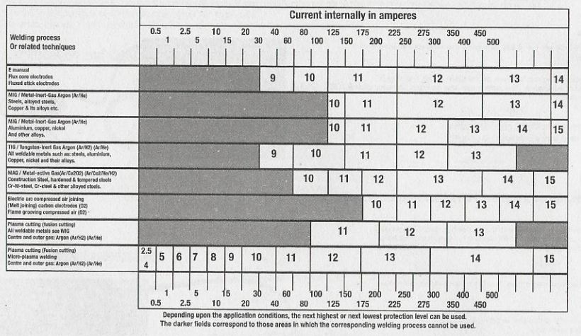

I just bought an ESAB Warrior tech helmet after doing some research into the options, one thing i'm confused about in the manual it is says it's suitable for MIG greater than 125 amps internal current but says not suitable for less than this, i'm using a clarke 160TM btw. It doesn't mention this in any documentation and I don't see this stat in any specs or ads online, so why could I not use it at less than 125amps? Is this the weld setting or something else i'm not understanding? I'm pretty sure I will be on low settings most of the time.
Thanks for any assistance.
