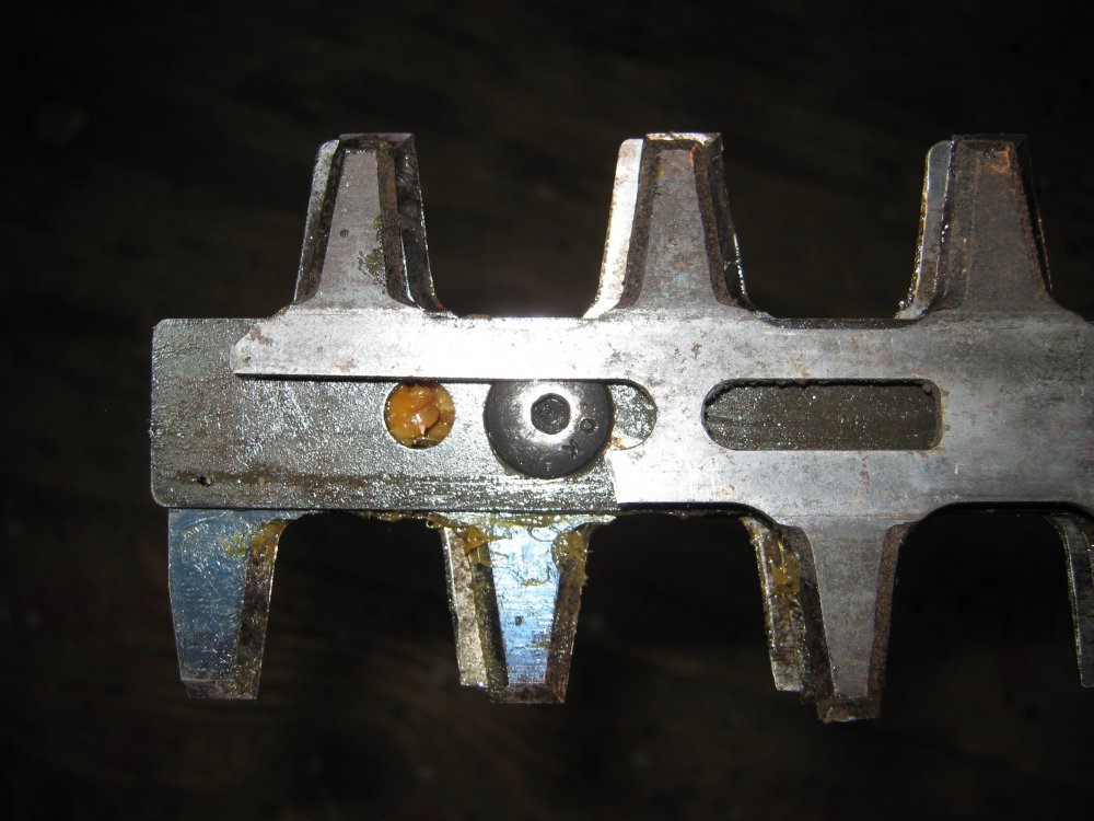

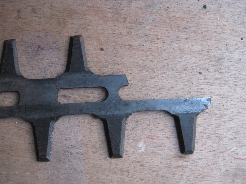

Ive just replaced a blade on my Husqvarna hedge cutter, £55 for one
I was wondering about the possibility of welding broken blades?
I thought of that, but its a double action cutter and theres 2 teeth missing, so the way the cutting pattern overlaps meant i would lose too much blade.Could you 'trim' the other blade to match? You'd have a cutter, just shorter......![]()
Assuming it's a high carbon steel only then you could do it with an A15 filler but I would heat it up first. The joint will be softer that the blade mind and its best to leave it that way rather than encourage hardness through quenching. A safe bet for welding unknown materials is 312 filler.I should have put a picture of the damaged blade up first, im assuming it would be high carbon steel.
Like i posted, the part is missing (i didnt break it), so it cant be repaired. This is for future reference incase there is another mishap.
What filler type would be best if a blade needed welded?
