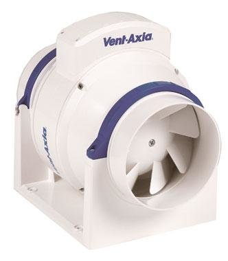

just fumes and an inline fan would be fine as its doubtfull there would be enough draw to lift grinding dust etc..
