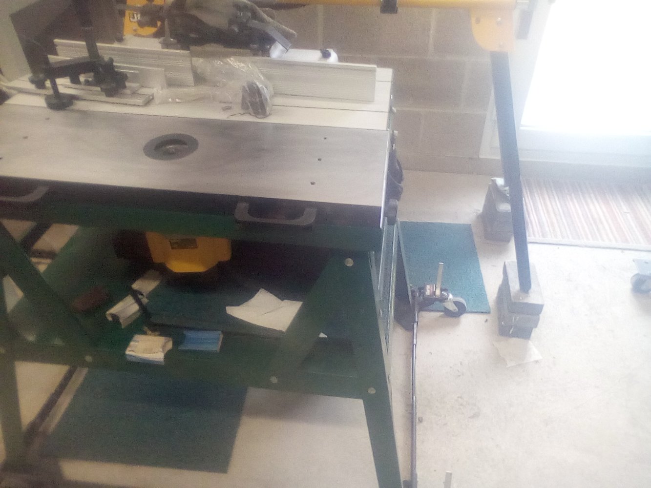

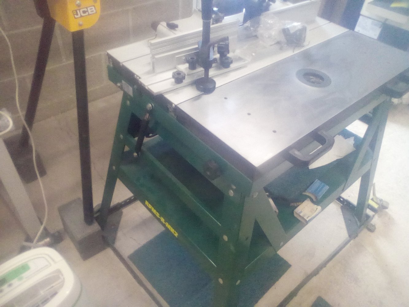

I'm thinking of asking the garage to weld steel extensions on the chop saw legs. So I can store my router table underneath, see photos.
The chop saw legs have an OD of 38mm. Looking through steel tube on Ebay I found, 42.4mm x 3mm. Fitting this over the chop saw legs as a sleeve, welding in position .
Would this be straightforward for the guy at my garage who does welding?
